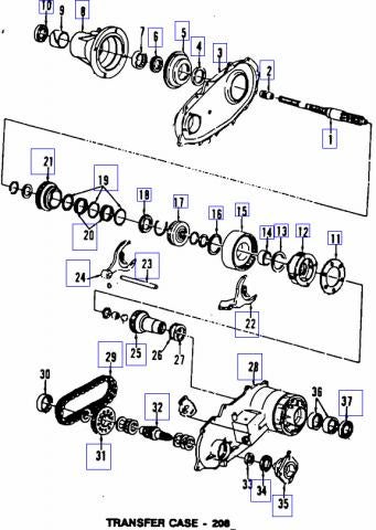

1984 K5 with 700r and np208. Rear output seal leaking, ordered new seal and it comes with a thin bushing.
Where exactly does bushing go ?
It’s probably the tail shaft bushing….I’ve always just purchased the seal from the parts store..where did you order it from?
Rock auto, timken seal, can get with or without bushing. I know the bushing or sleeve is suppose to help seal / take up slop but not understanding where it goes
Is it the output shaft bushing, #9 in this diagram? I can't remember if you can pull it out with the tailhousing in place or if you pull it and press it out from the inside.
np208-jpg.663207
You need to remove the out put shaft housing the replace the bushing. I recommend doing it, if old bush is allowing the slip yoke to wobble from wear the new seal will leak to.
I just did mine. You also have to remove the bearing to get access to push the bushing out. Change it as well, its cheap.
