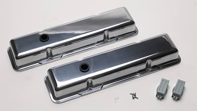

I found some of these Spectre valve covers for $40:
And picked up a can of:
To try to eliminate the valve cover leaks.
Since I run a vent and PCV system, I wanted to add some baffling. I was planning on fabricating something from plumbing parts, but found this cool product at O'Reileys, Mr. Gasket 5425 Baffled Grommets:
Anybody have any experience with them? They drop right into the 1 1/4" holes in the covers. I just glued some standard size PCV grommets into them.

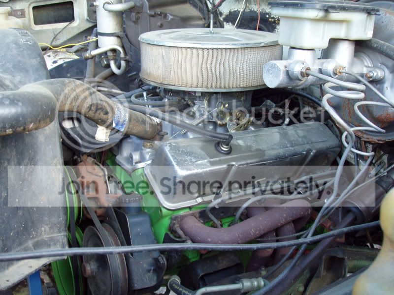

I use the Edelbrock valve covers. With the Edelbrock breather. I don't have any problems filling the oil at all.
56.jpg The breather is on the left just out of view.
57.jpg the PCV is right here.

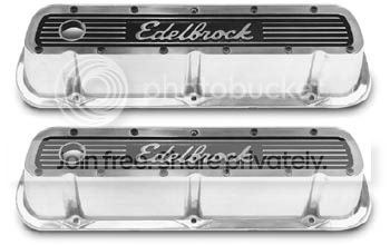

5022339_edb_4405_pri_detl.jpg I downloaded an image of my breather cap.
Your truck is the reason im getting those ones. I saw them on your post before, and it was between those and some flat black with the red bowtie. But i like yours the best.
I can't take any credit for them. The PO put them on. The minor thing I don't like about them is the fake allen head bolts fall out. You can see in the pic that some are missing, some are loose but they all do nothing.
Yah i showed my dad them yesterday online (my 20th is in a month...) he goes, yup I bought the exact same pair 20 years ago, those are fake BTW lol.
