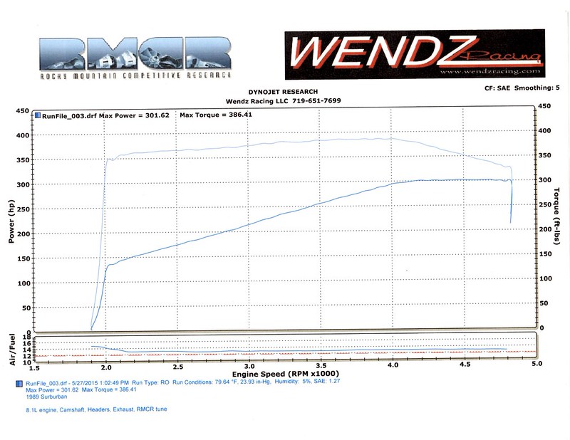

That is cool Wyoming boy! Nice numbers from a SBC. Hope you had better luck with RMCR than my experience with them. Mark that does the actual tuning seems like a straight up guy but the other guy, Mike, that runs the front end operation does a sucktastic job of running the business from a customer service stand point and has the personality of a rock. Forget about ever receiving a returned phone call or email from those guys although his sister that handles the phones is very sweet. You just have to keep calling and calling and calling or just drive by and look at them straight in the eye. I spent a day with Mark a few weeks ago where he did a great job of tuning my cammed 8.1L in my ’89 Suburban for full-throttle wide-open throttle operation but after getting it home the road manors still suck. It hops and jumps when idling through parking lots then they didn’t make any adjustments to the cold start/open loop speed density calibrations where it still has a hunting idle and wants to die until the engine warms up. For the cost of the tune ($575 in my case) and losing a day out of my busy schedule it is a huge hassle to take the trip back up to COS to leave it with him to rework what should have been done the first time. Ah, and I am still waiting on a returned email and phone call to them from 2 weeks ago. They run their business on word of mouth….not so sure I would send them business just yet but they pretty much are the only game around for tuning and hooning.
A dyno is very useful for WOT and all the high load tuning. A lot of those operating regions are tough to get to on the street, much less maintain. Some RPMs at WOT you hardly ever see, but when you do, the tune better be right or you might break the motor.
But basic in vehicle and driving tuning is still required to get the best manners out of it. You either need a guy that spends a lot of time in vehicle or reading your logs or have a tuning tool yourself.

I really like your torque curve :bow:. If I'd have known what I know now, I would have put a big block in mine from the start ! Something like a ZZ454 .
