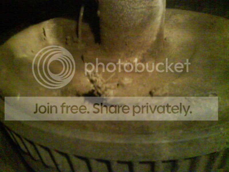

this is what i've got:
haven't pulled it apart to figure out how to remove the cable - if i spin those two bolts, they just spin and don't loosen.
I have everything to go inside the drums on a 1 ton 14FF. You have the bolt on style parking brake cables so Wes's parts won't work.

Nope, my cables won't work on those plates.
I'm assuming this 14FF you have is under the '73 listed in you sig?
If so, both cables will be equal length and bolt on at the plate end.
