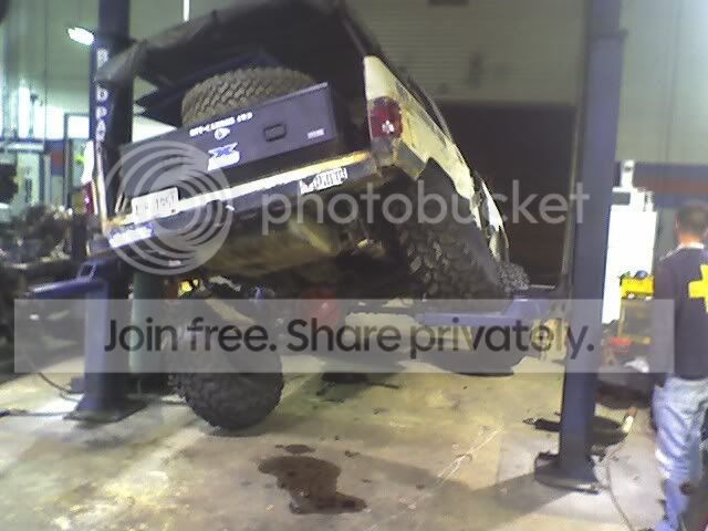

I've learned alot about these axles over the last year after swapping one out of a 72 Cheyenne to go in my 70 Blazer. I've got a 4.10 gear set with the factory no-spin. Brake parts are very difficult to find and expensive when available. I'm doing a rear disc conversion on mine and with disc brake brackets from Ruff Stuff. Some stuff is interchangeable with 14ff. With an open rear you can swap a 14 bolt detroit with 14 bolt rear axles. Like mentioned earlier the eatons only have 17 spline axles but mine show almost no wear after 35 years. I have acquired an extra set of axles in the event I ever break any. I know the pinion diameter is 2" just like a 14 bolt but not sure of the spline number. I would like to upgrade to a 1410 yoke but I am still checking. I've heard they go through pinion bearings quickly, but others have stated they haven't had any problems. Removeable center section makes it easy to change gears and sure makes it easy to move the axle housing around when empty!
