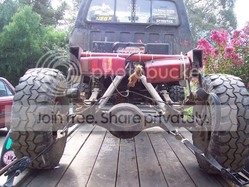

Some have factory Detroits :D . I'm kinda of a sucker for them. I get them for $100 at the local yard. I bought one with a 5.13 and a Detroit 2yrs ago for $50 :D . I was pretty excited.
3 widths 63" WMS,65" WMS and 70" WMS. 70" is real hard to find. Have one and need another.
edit: looks like it has discs already
