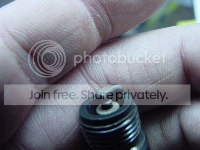

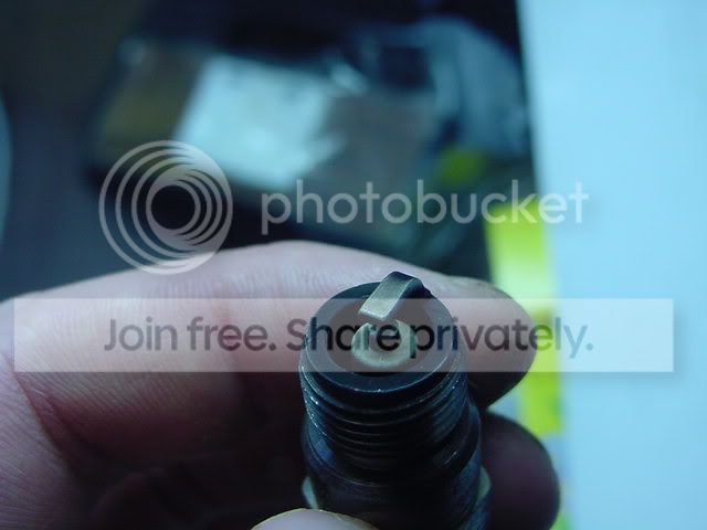

Why does this plug look like this

Do they sell a kit that had many different performer metering rods? I think I'm running a wee bit lean. (the plugs were previously fouled with carbon deposits from improperly adjusted valves, but that has been long burned off.) Any body got an idea how many rod sizes I need to step up to?

Are you having any driveability problems that might indicate a lean condition?:confused:
Stumble at WOT, one lean backfire at WOT, and running a little on the hot side (212*)
Do you know which color step-up springs are installed? Does it stumble momentarily as you accelerate with light throttle, but recover if you really put the pedal down? Does it stumble or backfire at low rpm WOT, high rpm WOT, or throughout the whole rpm range at WOT?

I believe it was low rpm WOT, and I would bet a ton of money that the stock rods are still in this 600 cfm performer. It only backfired once, and only really stumbled once. The motor running hot kinda pointed me toward running lean. And the fact that the plugs were so rediculosly clean, it burned off all those old carbon deposits that we left on the electrodes when the valves were way out of whack and the fuel wasn't burning off properly. The deal is that I haven't really messed with any adjustments on the carb. A shadetree mechanic put it on my old 283, and I would bet money he only fooled with the idle mix screws. If that's the case, maybe I'll get lucky and not have to buy any rods or jets. I didn't get to borrow that vaccume gauge today. Can the Idle mix screws be easily adjusted by ear?
