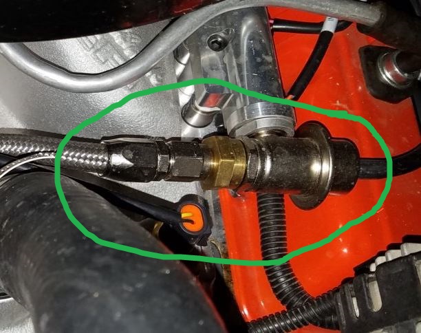

I might be missing something here. I have had no need to trace fuel lines yet but are you saying the lines are actually two piece units with another set of couplers at the frame rails. So one set runs from the tank along the rail to roughly the shackle area and then another set joins there and runs up to behind the TBI?
That is correct. The lines between TBI throttle body and the frame rail is a stainless braided hose. Then there are threaded connections at the frame rail near the shackle. Incidentally, there are the same threaded fittings for the fuel filter, obviously only on the larger supply line.
Best picture I have.
You can just make out the steel braided hose on the right of the one fitting.
Ok Cool , Ill have to take a closer look when I get home today. So basically just hook up there with some Earls line, run it forward on the rail and then up on the pass side of the block similar to old school mechanical pumps.
