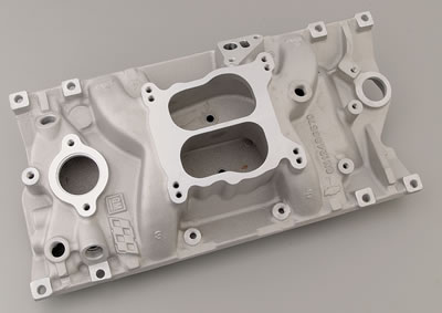

Yep. The money I save by not buying cast aluminum perimeter bolt covers will help with the extra money for the quadrajet/vortec intake manifold.
Was thinking about this bad boy.
Can keep the hotair choke with the GM intake. But have been thinking maybe I can get the Performer intake and convert to a manual choke.

I would keep the hot air choke. I like it better than the electric choke as is KISS all the way. Either way you are fine though. Techincally with the electric choke in order to get the full benifit from it you need the heat riser from the exhaust and a few other little things. Unless its really cold where you live i wouldnt worry too much about it.
Those work OK but the cable tends to not like sharp beds AT ALL! LOL I'd keep the hot air choke if the carb is calibrated for it. Will run better and cause less issues.
