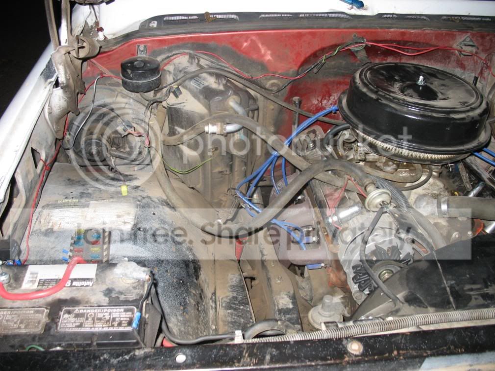

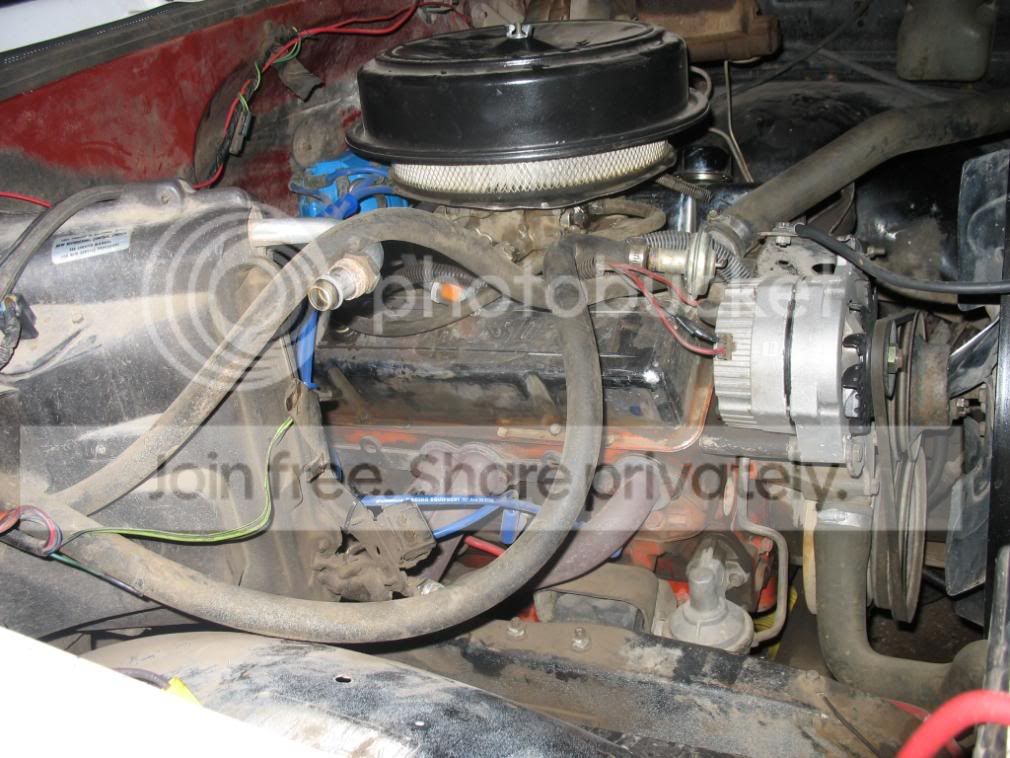

Dafey, take a pic of the front of the motor....
man, this got me confused... I had to look back up to his post and see that it had been edited since I replied... :doah::haha:
Does that help? If not I GUESS I could freeze
my nuts off an go snap a pic.... :eek1:

looks like they have the temp sender in the head, and it looks like you have a 1/2" npt plug on the front of the intake, under the neck.. perfect... put your thermal switch in the front of the intake where that pipe plug is....
Hey could I get a 90* then I wont have to change the houseing?:laugh:
:confused: what housing?
it looks just like a sending unit... on your driverside head, you have a red wire running to your temp sender, it'll be just like that.. except sticking out of the front of the intake.... you may have to put a bushing on the switch to bring it up to the hole size..

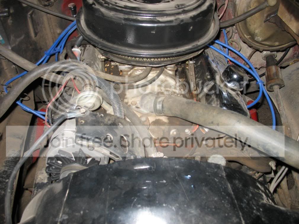

Any way its a hex bolt right under the water neck that im talking about.
That why I asked about a 90*Only about 2 finger can fit under there...

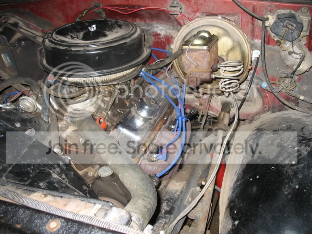

Can It go in the pass head?I can look there too when I go out.

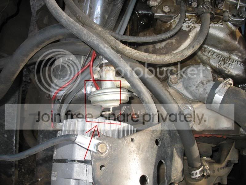

EDIT: here ya go.See the squair bolt hole.can one go there?
See how it right under the neck?
you could snake it in there it looks like.. might need to pull the hose to ge it in. and just make sure the switch sits down in far enough that the post of the switch isn't stabbing the hose when it's together..
Thats what Im worried about,Its actually more under the hose than it looks in the pic.Whats the bolt/nut in the back of the head that looks like the check plug in a diff?Above an in the middle of the plugs.
thats a water jacket too.. but i would suggest trying that front intake spot, even if that means changing to a different waterneck... I would try it as is first tho..
if all else fails, try the head plug, it may be a real b*tch to get out tho...
