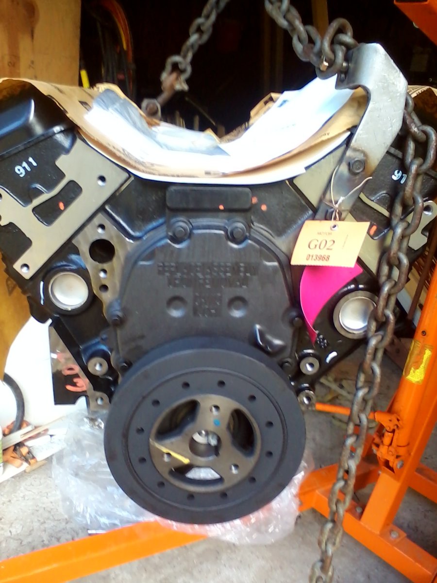

What kind of vortec heads have you got? Because the ones I have are missing the hole that is usually there on non vortecs; they are GM ones can’t remember casting number I think 062s but could be wrong.
If you have edelbrock heads or other aftermarket ones you may not have this problem.
Apparently 906s. Took me a while to find a picture of the single hump casting identifier. Hadn't noticed it wasn't the sawtooth before.
