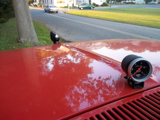

I have 3-4 mechanical gauges floating around that I could plumb in for static reference... hoping to get something permanent for driving reference that isn't mounted on my hood...

I vote that @Justin V should do the hood mounted gauge. I think it would be neat and different (aside from ryoken who is a good example to follow anyway).
