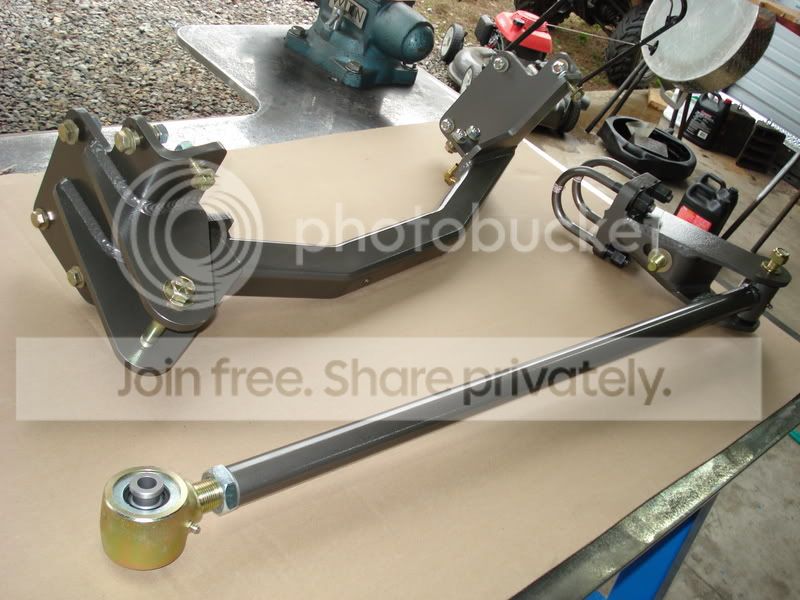

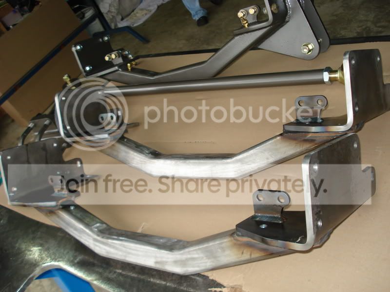

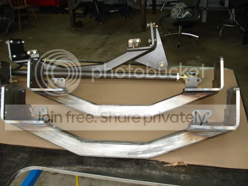

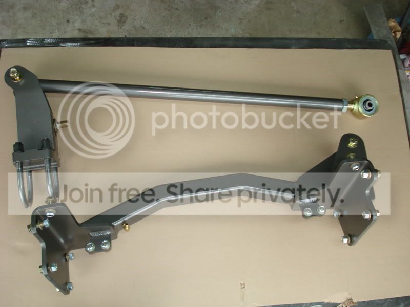

Hello everyone, my name is Dave Cubbage. I build engine crossmember/panhard bar setups for the '73 to '91 full size GM trucks.
I custom build these in my spare time as a hobby, more or less, so therefore at this point I don't pump them out in large quanities.
The basic engine crossmember is a stout piece that replaces the factory crossmember and is easily upgraded to utilize a panhard bar by just welding on the p/h bar mounting tabs. This crossmember currently sells for $130 plus shipping.
The crossmember/panhard setup combines the engine crossmember with a panhard bar that really wakes up the steering response on a rig with crossover steering. It pretty much eliminates all bump steer and has been proven to counter death wobble on a couple vehicles that it's been installed on. This setup will work with d44, 10b and d60 axles.
These currently sell for $330 plus shipping.
Have 2 questions for ya. Do they come bare or painted? Also one of the pics shows a crossmember with some fittings of some sort in it, what are those for?
Dump question:
How does this part mount?
I'm curious about the U-bolts.
Yep, bolts to the passenger side tube. The bolt you see protruding thru bolts to the u-bolt plate sans sway bar.
I ship them painted with Rustoleum Hammered dark bronze.
The fittings are there to attach the axle vent hose to if you choose to. Just a little extra feature that cleans up some clutter under the front end.
