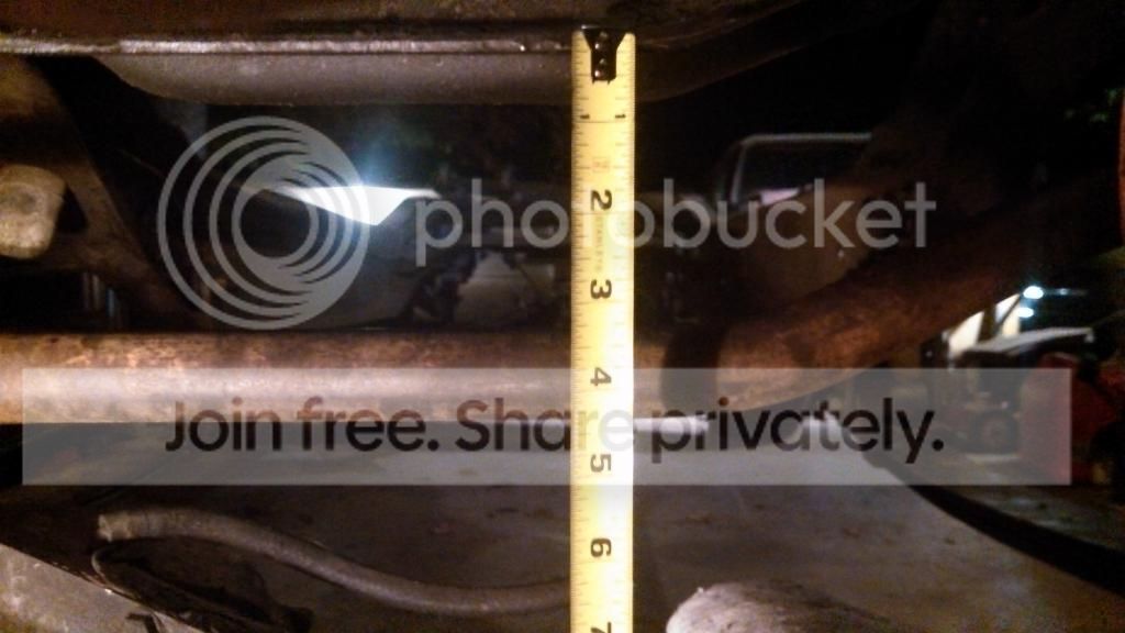

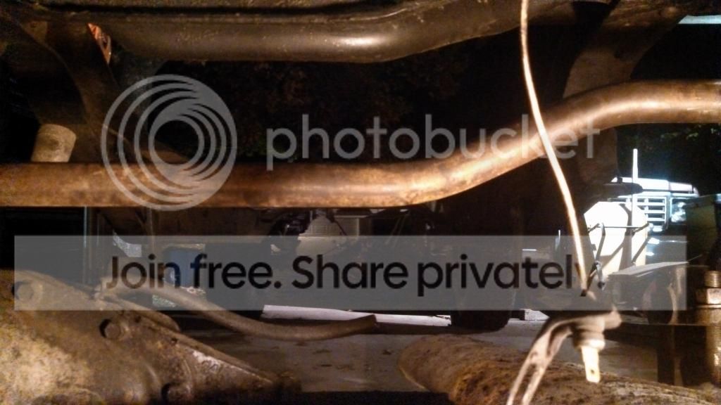

I'm also running ORD crossover and the factory crossmember with ORD steering arm and no clearance issues. This is with a 6" Superlift HD spring up front.
Not a good representation because the pics are of just the frame, but it did drop down about 1.5" with the engine and cab. It has not hit yet with the factory crossmember, I am running the ORD drop pitman arm and bent drag link. Also I have limited uptravel.
