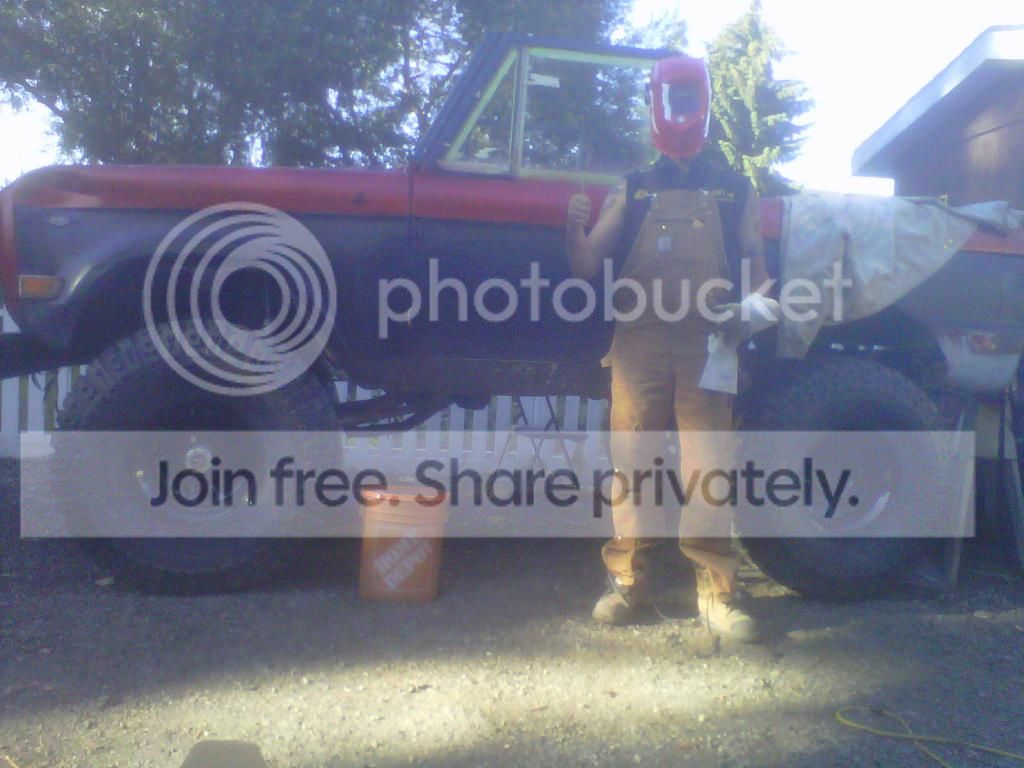

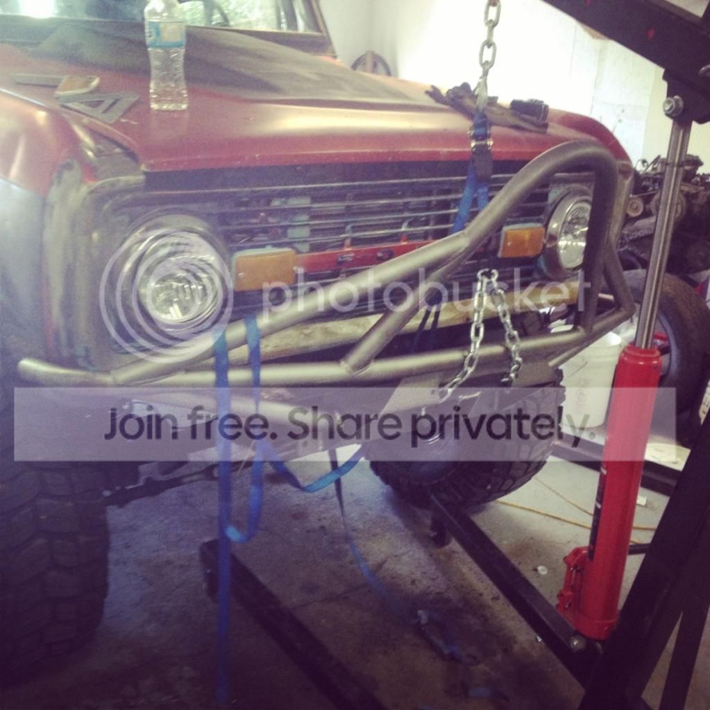

Here's the disaster of a truck and its owner. I know you guys like seeing the grill we're talking about!
All I saw was blah blah, then oh sweet bronco.
And then I thought, I want more pics of that sweet bronco.
Sweet bronco :thumb::popcorn:

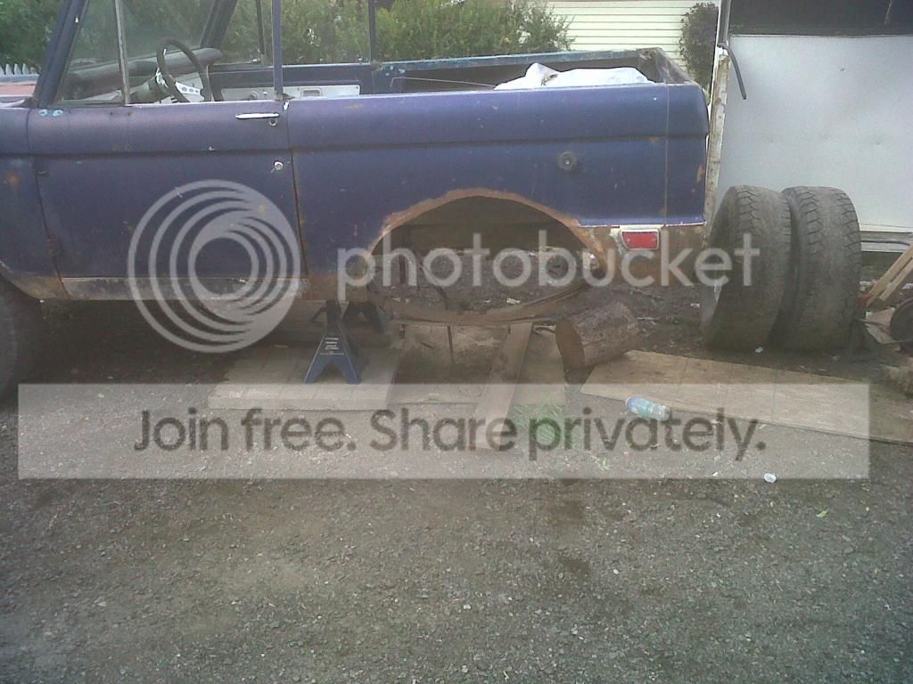

Ha! You see sweet Bronco. In my mind all I can think of is where it came from. To give you a little history... I get a phone call from a buddy that he brought home a sweet 68 bronco for a project. I get all pumped, go to his house to check it out, and this is what I find.
All I could do not to beat him to death.

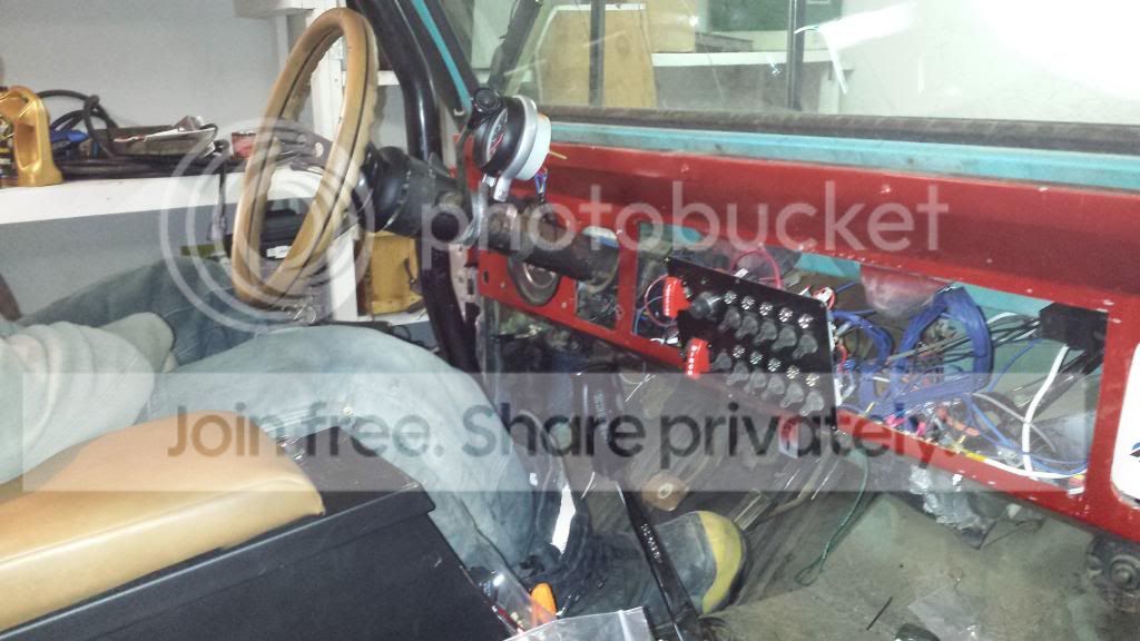

A few pics of the progress over the years to pique interest lol. I'm sure I have some of it done too, can't find them...
Other than that ther tar bein' backards, I got nuthin.
