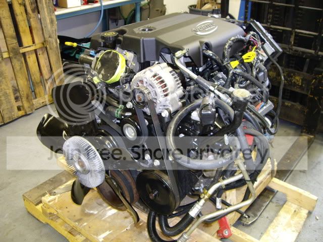

I dropped the hammer on the 8.1 it is really what all I want and need in one package.
This....
Will soon be in here.
Thanks Pacific Fab!
