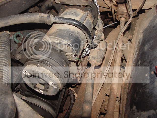

I want to keep the Air Condidtioner for the time being, but I don't want to/ cant recharge it, becaues its R12 (and no I don't have the $$ to convert to 134)... anyway I want to set the compressor on the passenger side of the engine bay. If I connect that hose running under it to the front of the bay (the hose with the cylinder middle ways on it), will I discharge the sytem? or does that not connect with the freeon? How do I disconnect that hose, I don't see any screw type fitting...
You will have to move the compressor with the lines attached. There is no other way.

that's evil :doah: how in the world will I move that compressor with such a short line running to the front of the truck? Just lay it on the front above the grill?

My last K5 we did a cam swap without disconnecting the a/c. Find a place and use wire or a hanger to keep it out of the way.
