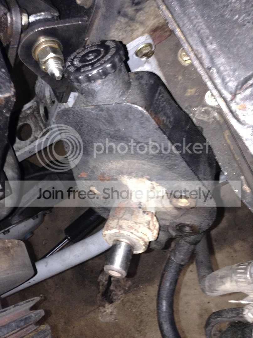

Well craig brought me down the right bracket. I just guess I no longer have the right pump.... :dunno:
Where the top flange is on his, is where the cap of my pump goes. So must be different pumps out there? Mine is on right, one craig brought is on left, with the adjustment and second tab.
And if you look at this. The bolt holes in relation to where the cap would be (big circle)
Ok craig sent me a pic of the pump he took off the bracket. You can see the holes are rotated from mine. Mine are where the blue circles are.
I'll look tomorrow when I get home from work, I probably have the bracket you need.
The pumps are the same. It's the reservoirs that are different. I went through this putting a truck pump into TPI brackets. If he isn't using that pump you can swap the reservoirs in a few minutes and then it should bolt in.
Cool. Ill just do that.
