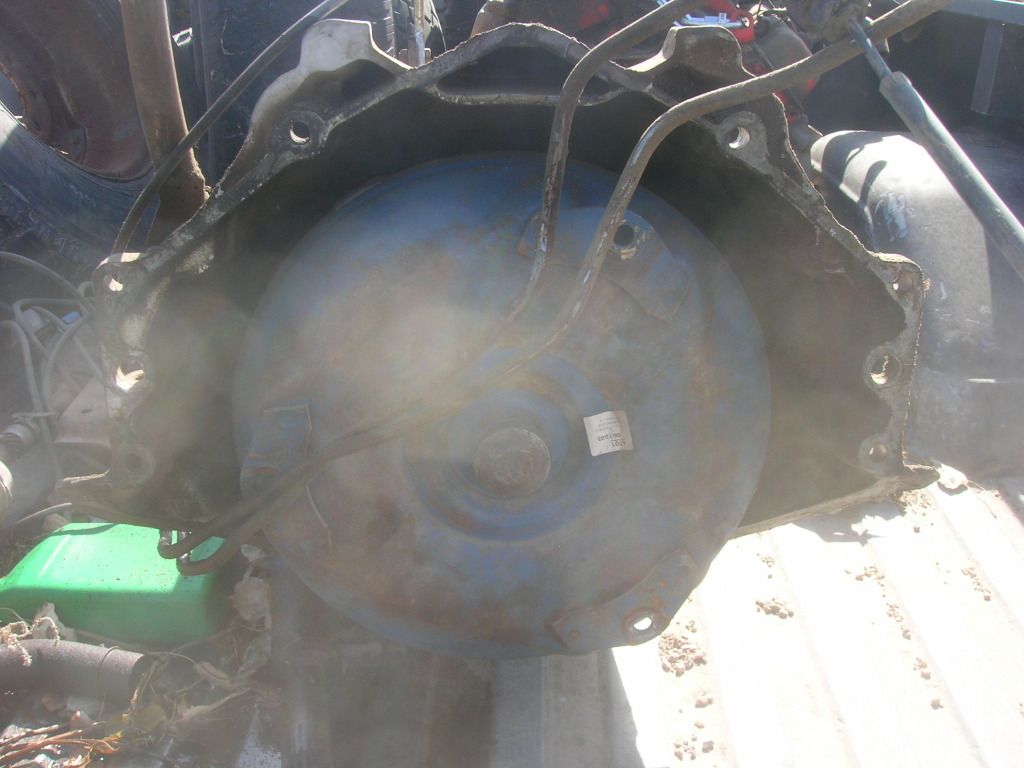

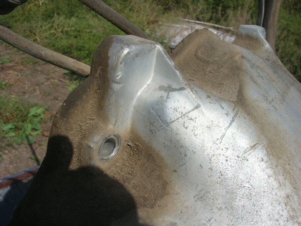

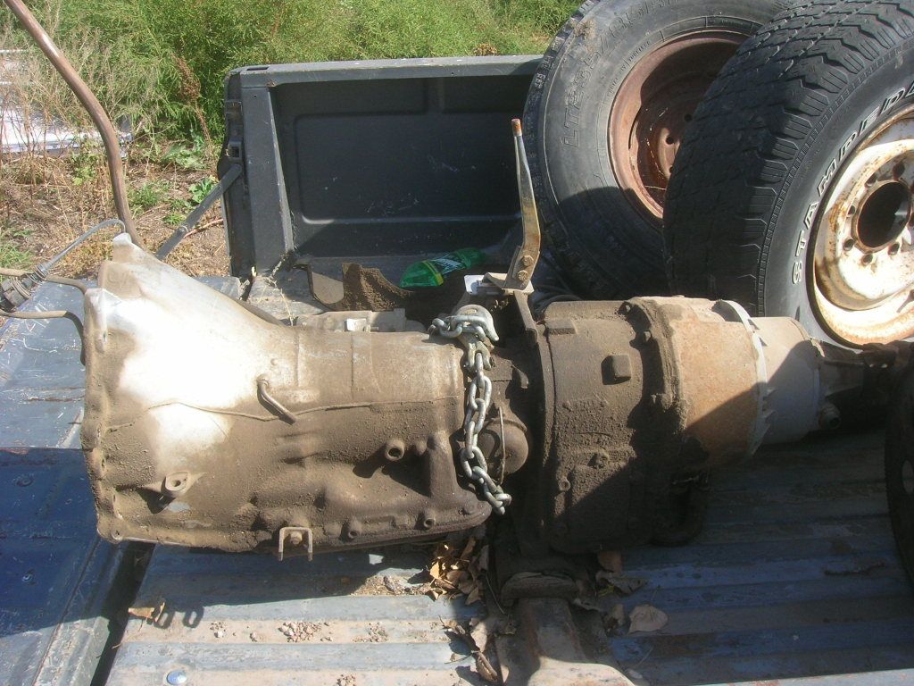

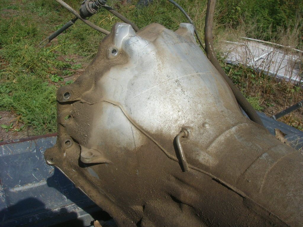

. . . . dual pattern TH350 in a 4x4? I have one out of a 1977 K20 I just cut up. It has the dual pattern bellhousing, but the BOP holes aren't drilled. Seemed odd.

Most of the dual pattern TH350's we sold at the junkyard came out of 78-82 Olds Cutlasses and Monto Carlos,and a few Buick Regals had them...never saw one in a 4x4 truck,but there is no reason one cant be used I suppose,if you swap in the short output shaft...I never saw one that didn't have bolt bolt patterns drilled however......................................................................................................................................................................................................Gm had some labor strikes around 1978 and that is when they started putting chevy 305's in just about all GM cars,you could buy a Pontiac Bonneville with one,or it might have a 301 or 350 pontiac ,same with olds,everyone "shared" engines to offset production line shortages.............................................................................................GM eventualy had class action lawsuits filed against them because some owners were very unhappy to find their Pontiac had a Olds or Chevy engine in it..thats when they started using the multi-pattern trany bellhousings too--it was nice for us parts swappers during that era,with the right motor mounts you could put just about any GM engine in anything!..............................................................................................AMC used the TH400 in Wagoneers and Jeeps,but it had their own bolt pattern in the bellhousing,everything else was GM and identical to a chevy though...
Pretty much all G bodys (IE: 78-88 Cutlass, Regal, Monte Carlo, Malibu, El camino,Grand National, etc) had dual pattern th350 and th200-4r's. I bet that those 4wd dual patterns were from or left over from when the olds 350 diesel was offered in the plant that said truck was born in.
I'm not 100% sure when the Olds 350 diesel was introduced--I am pretty sure my former boss's Caddy Seville with one was a '77,but I could be wrong...I think cars used them before trucks had them,I think 1980 may have been the first year GM trucks had them,they only sold them for a couple years before admitting failure and they came out with the 6.2 in 1982..................................................................................................I bet Stormis is right about the 4x4 TH350's with dual bell patterns being leftovers from the Olds 350 diesels!...
