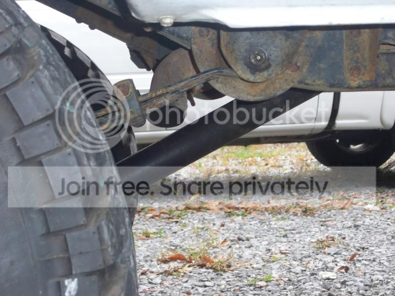

my exhaust exits out the sides behind the rear tire. it was straight cut and i choped it off and put turn downs on and it got a little better.

Over the years I've seen some shorter air scoops on the sides too. My exhaust comes out the sides behind the tires and its a problem when im on the trails, when the back tires come off a rock it wants to twist my exhaust off
