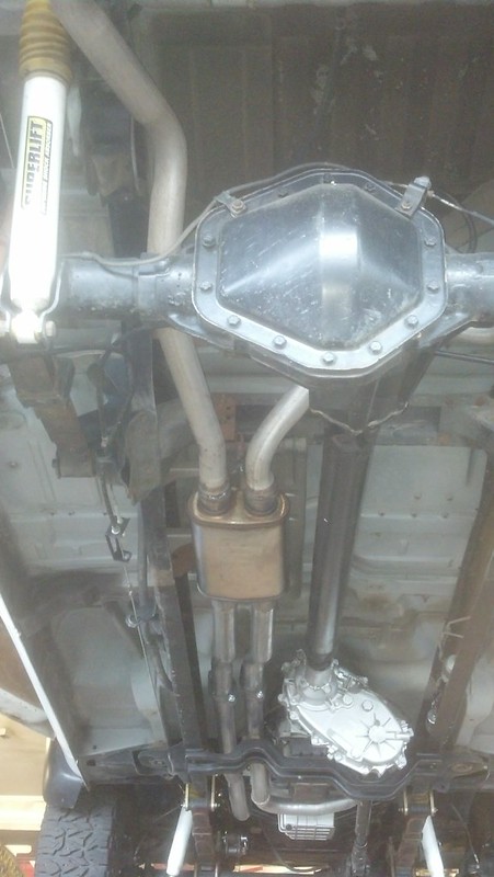

Nah, I got rid of the Fagnaflow long time ago on my Suburban and replaced it with a Spintech, which I don’t like either. Probably going to just follow the recipe of my K10 and do a H pipe with two cheap Thrush mufflers and call it good.

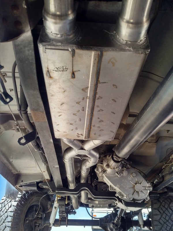

Spintech with an X-pipe. Not fond of this either

Hell, the Magnaflow was a total machine gun. It was terrible. The Spintech isn't poppy but the interior drone it horrible. I have yet to ever use a 2 in/ 2 out muffler on anything that didn't drone. That said, the K10 with true duals, H-pipe and Elcheapo Thrush mufflers doesn't drone at all but is poppy when cold but once it warms up it sounds really nice. I want that same sound on my Burb sooner or later
