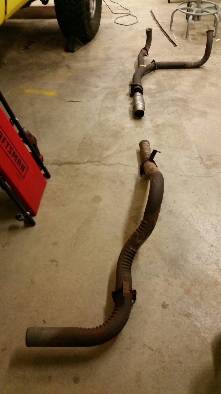

picked up these pipes today:
Since the y-pipe is only 2-1/4 it's a compromise on what I really wanted but I think I can make it work and for $20 it's worth a shot. It only took me about 15 minutes to grab too.
If it sucks or I can't make it work I'm really not out anything so I figured why not. :pimp: Heck, maybe if I get it all together I can at least use it for a template for some mandrel bent stuff.
That looks like a good deal. My exhaust on the crewcab had pretty much the same layout. I had to change the first bend off the exhaust manifold on the passenger side. Basically changed the 90° to two 45° bends to cut that corner a little tighter. Even after that, I've still managed to hit that pipe with the front driveshaft but I think that was before I had bumpstops in.
