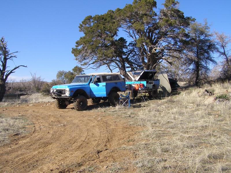

I built an expendition "tear drop" last summer. It was nice. I had a custom frame built (most tear drops use Harbor freight cheesy frames). I used Pro-Comp suspension with spring over lift and used the same hubs as my Blazer, so the wheel pattern was the exact same and Im using the same GM rally wheels that are on my truck.
The camper was fully insulated, roof and flooring and was pretty awesome actually. I was heartbroken when I had to take it apart.
If you can see the entire album, youll see the build pics from beginning to end and youll see how bad the mold had gotten in a short period of time.
ANyways. the "box" was 4' x 8' and it was built alot like a tear drop with the "kitchen" in the back. And you had the sleeping are which was 4' wide and over 6' long. The back area had a 10gal water tank with pump and faucet. I had special deep cycle batteries all wired up. It had LED lighting, complete with dome lights, porch lights and it had DVD player. Electric push/pull fan. I used Tear drop doors and got some RV windows from junkyard. The interior looked like a mini cabin.

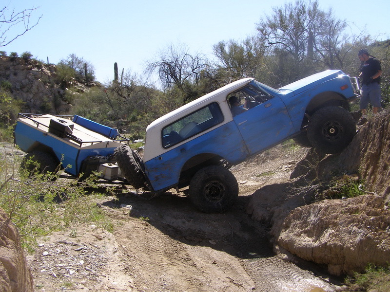

This was once I got it built and out testing it off roading. Im using a TREG style hitch setup, it allows full rotation and up and down and side to side movement. No slop and no noise.
