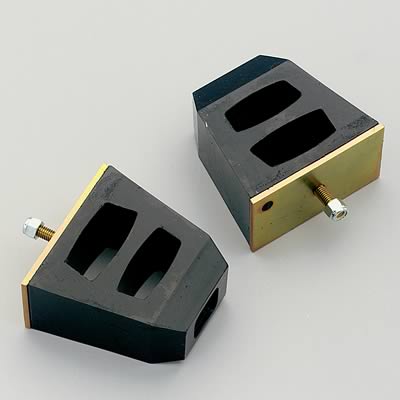

I just fabbed up new brackets. Most I've seen use a piece of 2" square tube as a spacer or get the big 4.5" tall competition mounts. Like these:
With a 6" lift you may need to use a combination of both methods.

I made my own bumpstop mount and used 4.5" progressive bumpstops like mrk5 posted.
