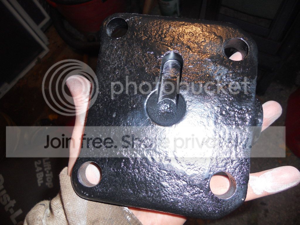

I installed my Ez-inch in a odd way apparently. And now I am wondering if this is going to be trouble. take a look and give me some feedback. It is bolted to the pack securely, and the entire spring perch is touching the ez inch, so i am not missing any contact area. Can I run it?
They are in upside down. The radius side go towards the springs. It prevents stress cracks from forming.
Yeah, I was more worried about the offset to the rear. I had to do that in order to use the stock spring plates on top.

when i installed mine, i milled out part of the stock plate in order to fit the nut end of the bolt. I relocated mine an inch forward but depending on how close you cut the bolt you may need to make more clearance in there.
The EZ inch should always be centered over the perch.

Right, I'll get it moved around then as soon as I get some new spring plates.
1: Thearborbarber is right. Your block is upside down.
The sharp edge will cause your bottom spring to break.
2: You should never use blocks on the front axle.
3: You should never reuse U-bolts on an axle.
4: When using blocks, they should always be centered and locked in place so they can't slide out when you find out why you shouldn't reuse U-bolts.

This isnt a block, its an ez inch, it bolts through the springpack so its not considered a block,the reason you arent suppose to use blocks is because there is more stress on the turning axle and they can give a bad ride and move around. But the ez inch is bolted to the leaf springs and also the head of the bolt sits in the hole on the perch, so it will not move around. Its only of the cheapest ways to get lift without messing up your caster angle with increasing the shackle length.
Correct.
