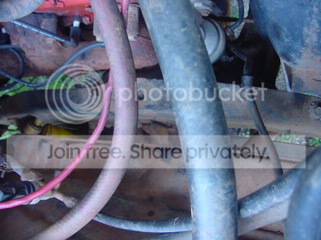

Fabbing up engine protection, Will this work?
78Suburban
Jul 4, 2005
2,609
Georgia
See that little gap between the chassis and the inner fender? Alot of mud flies through there. What if I snipped some roofing tin or some thin sheet metal and filled in the gap? Would that create an overheating problem of any sort? Would I just attach it with small sheetmetal screws? I can fab one for the other side, but there won't be as much clearace, because of the steering junk. Will this idea work?
Thanks,
James
I used truck mud flap found at my local tractor supply store. Cut to size and used 1/4-20 bolt and nylon nut, worked great. Tin would work too but the body does move around. Good luck.
By the post title, I thought you were going to be building a monster oil pan skidplate. My mind always goes straight to the rocks, but I guess protecting from mud would be good too.
If they're still available, GM put "flaps" there when the trucks were new.
I need to do this because 2 times, my truck has sucked in water because it came through that gap. I also have a 3in body lift so that even further separates the frame and fender.
