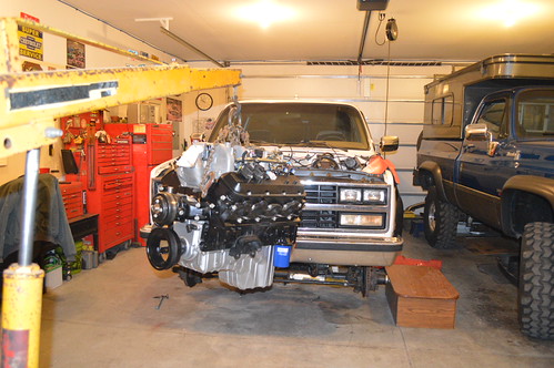

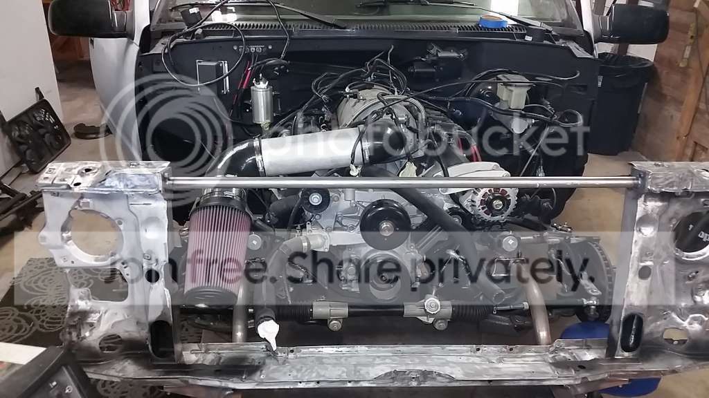

Should be easy peezy. No need to pull the engine and trans together. I pulled a 6.2L out of this 6” lifted Suburban with a broken crank. The engine would only rotate a few degrees each way, which was not nearly enough to gain access to the torque converter bolts. I just eased the engine forward and tried to keep the TH400 and engine as even as possible in order to pull the torque converter straight out of the trans in an effor to prevent damage to the trans front pump. I’ve pulled locked up engines out of vehicles for over 20 years like this with not breaking a single pump. Typically, replace the front seal afterwards though just for precaution though.
There is also no need to ever pull a front clip to do an engine swap, unless you’re doing some elaborate Cummins swap or something like that were the engine will be going in and out many times for test fitting. Growing up in a shop through today I have never once saw a front clip removed from ANYTHING for an engine replacement other than a medium duty truck with a tilt hood. I’ve actually never seen a clip removed for an engine swap until internet forums were invented and pictures from diy mechanics started surfacing :haha:

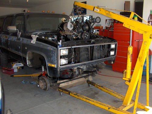

If the vehicle is lifted just remove the tires and support the frame with jackstands as low as you can possibly go even if the front brake rotors must rest on a board (rest, no let the entire truck weight lie on the rotors). Letting air out of the rear tires also helps bring the complete lifted vehicle down low. Pulling the front clip opens yourself to new cans of worms by breaking bolts, chipping paint and never getting the body lines back straight again not to mention wiring issues once you open the bulk head connector at the firewall if your not very careful. Pulling the clip cost more time than it ever saves. You will never see a flat rate mechanic pull a clip off anything unless it is absolutely required.

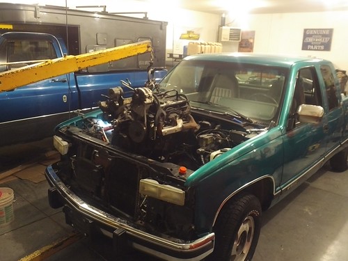

This is actually the picture of a turbo 6.5L going back into the void the dead 6.2L left behind.
Up and over. The rotors are not on the floor but they look close. Just enough room to roll the cherry picker under the axle is all you need

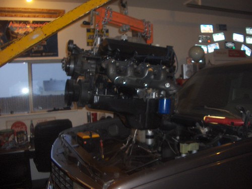

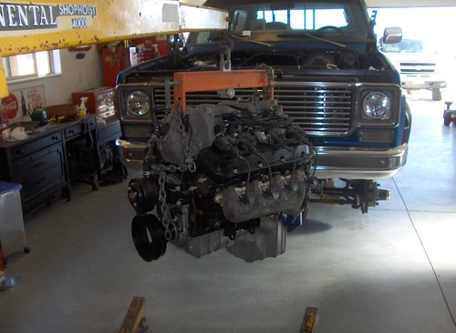

Same thing….up and over
See a pattern here :haha:
Even video… BTW, I do 90% of my engine swaps alone and I am not a big guy. Work smart, not hard

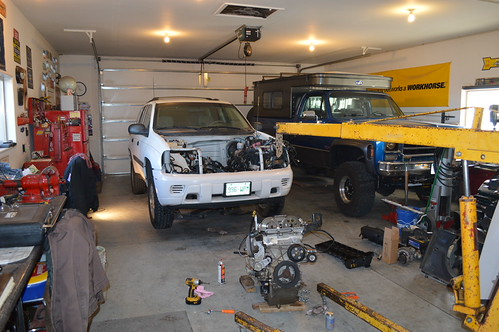

Oh, and these little POS trucklett Trailblazers even though they aren’t really a truck. What a MOFO engine swap this was. Pretty sure these Junkers were intended to be throwaway vehicles as that engine is not an easy ordeal to get out. I was about ready to take sawzall and cut the body from the B-pillar on forward and rip the front end off. Next time @ZooMad75 fries an engine in his wifey's family truckster he is on his own :haha:
You won't have to worry about that! I'll cover that beast with gas and let you light the match. By far the most hateful engine swap I've ever done. Yuck.
