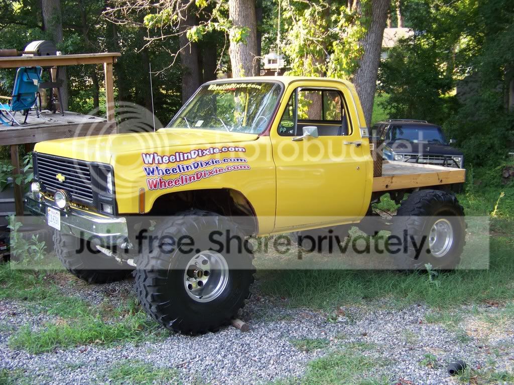

my truck only has a 4 inch lift and on 42 is huge my friend has a blazer on a 10 inch and 38 and they sit even, im also trying to go lower or the same height it is now.Its for all around mud sand and trails no rocks as of yet.

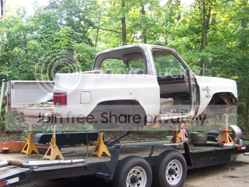

Readymix: thanks for the pics, if you could snap a pic of your cut line in relation to the lower mounting hole of the front fender then that would be awesome. Thanks.
thanks for posting pics. So do you think i would be fine w/out that lower bolt that connects the fender by the door? If so then i'm just going to hack it off, but i dont want the fender to feel "flimsy" and not have any support so i guess that i why i was asking.

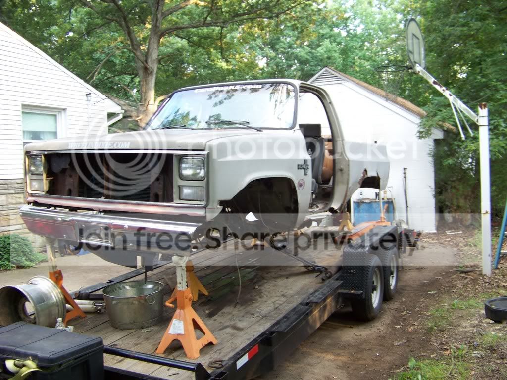

There are two mounting bolts at the bottom of the rear of the front fender, right? Its been years since I cut my fenders like that but I never had any problems with the fenders being too flimsy and I'm pretty dang sure I had to remove the forward most fender mounting bolt.
i'm pretty sure there was only one lower mounting bolt of the front fenders. I just cut as near to it as possible...which still gave me a ton of room and the lower part of the fender was secure. To keep the inner you can just trim everything below the bolts that mount the inner to the body tub.
The front part of the fender I trimmed off flush with the underside of the core support.
