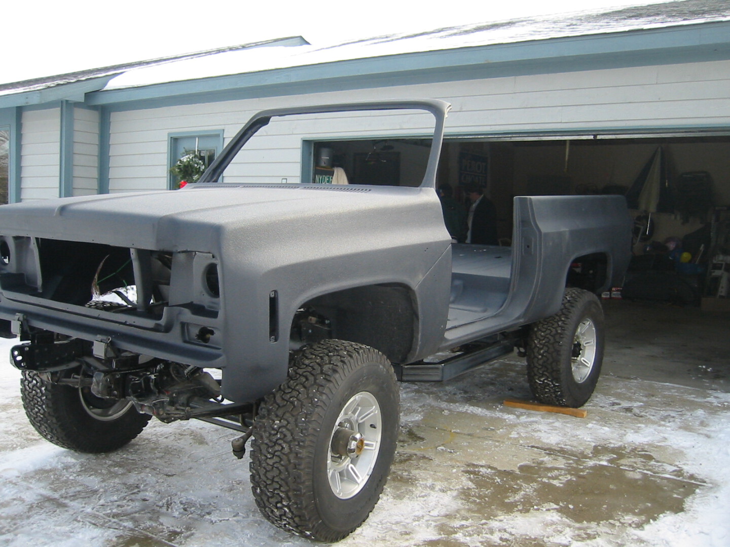

UPDATE: Getting there, doors/tailgate assembled, roll cage on, dash/pedals/brakes/steering column all installed.

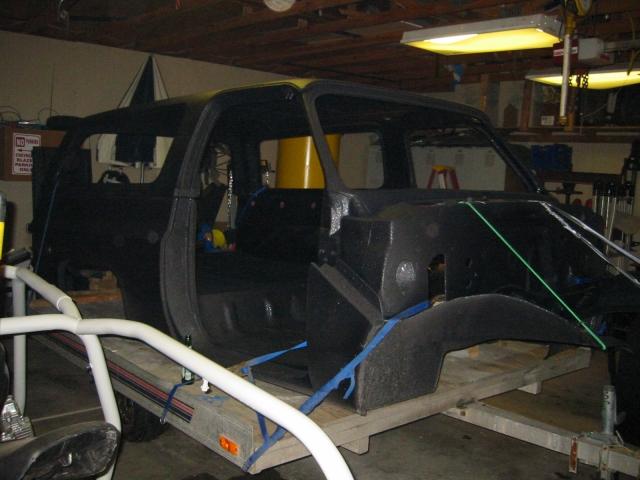

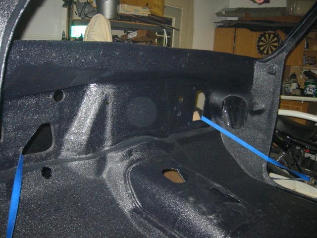

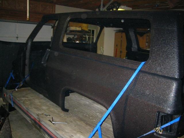

Here some bad pics of my US Body Source fiberglass body back from the line-x shop. I had the entire thing done, inside and out. BTW, it's GM indigo blue, but it's hard to tell in pictures.
I'll take some better ones when it stops snowing and I can push it outside.
After 4 years of cutting/drilling/fabbing/reinforcing/fitting/swearing/bending/beating on this body I can finally start final assembly!!!! 4 years down, xx to go....

1. The doors are the 73'-'75 style. My Origican K5 is a 1973. Actually I had two '73's, both rusted beyond repair. I bought new steel doors, and cut them to match my old doors, before Line-x. (It's best to try to get everything you can possibly get cut/drilled done first, then Line-x.) I then cut out the OEM door reinforment, and carfullly welded it in place in the new doors.

4. I did get the clip from US Body. It's thier 1 piece tilt front clip. I didn't take a pic of that yet.

He said it took about 6 8' truck beds of material. He charged me $2500. (I've been saving!) I did do everything, doors, gate, front clip, and body tub, topper and 3 or 4 smaller misc. pieces (trans hump, tailgate access panel..etc..), the tub was done inside and out, and the underside included, and I told him to cake it on the bottom just incase US BOdy didn't get all thier wood reinforcement encased in the fibeglass. The top was done inside and out too.
I really like it, I already banged a few parts into it, and you'd never know! I think it was a good choice.
