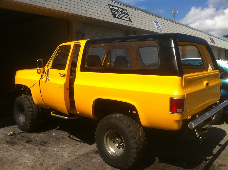

I busted the glass in the top to make room for the lexan speedglass, I plan to use the black top on the yellow 1977 k5 blazer. I am going to switch the tops for a week or so be for painting to see if I like the roof black or white on the yellow truck.. The body work is about finished on the 79 so soon I can pull the tub and under coat...

79 & 77 side by side
https://picasaweb.google.com/lh/photo/4AK6H4AFK-IAIFbVw6dQ7g?feat=directlink

my 1977 tonka
finished the top put in the speedglass with factory gaskets

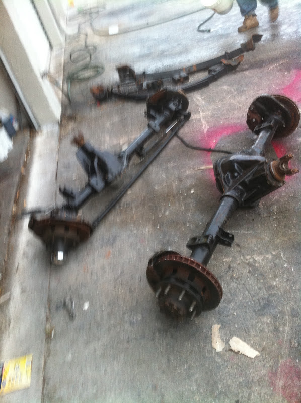

built axles
Well I picked up a set of axles today..... I was told that the set was a dana 60 front and 14 bolt rear and that both had axles and diff's put in....
At first look I'd say the front axle is a 10bolt with 8 lug axles :doah:.... I dont think the 10 bolt ever came with 8 lugs like the dana 44 did, so think this was done when the axles were changed out.... Ther rear is a 14 bolt and both front and rear axles have diff's added but still have to check the ratios and axle spline....
I'd have walked away from even the built 10 bolt, even at $800 for the set with the 14 bolt. If I did not have 2 k5's... I have planed to build a set of 1/2 ton axle for the 79 street truck... What I will most likly do is split this set and put the built 10 bold under the street truck with 35" rubber and re build the 12 bolt and go to 8 lug axles.. For the 77 I'll just have to buy a dana 60 and use it with the 14 bolt.... At least both truck will run the same patern, and the 14 bolt is a disk rear.....
now I just need to find some one who built a 60 and 10 bolt :dunno:
it's an 8 lug 44 or 10 bolt depending on yr.. same thing... dana 60 is 3 U-bolts, then 2 bolts.. that has 4 U-bolts..
ya thats what I checked right b4 checking the diff.. The spring pad is the 4 u bolt one :doah:its a 10 bolt or a 44... I dont know what year truck the front axle was pulled from but it look exactly like the 10 bolt fronts on my trucks 77 and 79..... I will not know the spline count on the axle untill I pull one and count it then I'll know if there after market or not.. I can tell the axles have been both gone thro and have tru & diffs in them.... I checked that b4 loading them....
I have heard after market axles are good for up to a 39" in mud... I will only run 35" on the red truck so the little axle will do her fine....
I want the red k5 built factory,,, shooting 4 built 1/2 tun axles, 350 4 bolt, 700r4, np205/203 doubler, 35" rubber.
I want the yellow truck bult for mud, built 1 tun axles, 350 4 bolt, ranger O/D, sm465, "atlas doubler" 40" rubber.
still need parts to make it happen..... but the list is gitting shorter.....
up date....
Well its a pain to put 8 lug onto a a 12 bolt, I just have to run this axle set with the 14 bolt on the smaller truck.....
