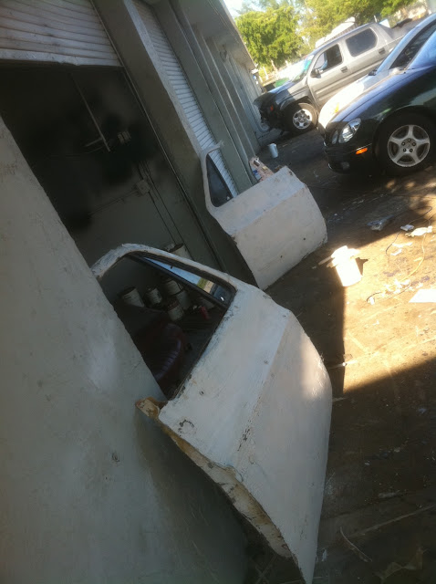

I put the doors on installed the door latches and stikers need to trim them and start the body work.... I ran low on gelcoat on the finle out put of the doors so had a lot of shrinkage and it left me with a lot of body work.... the door is not closed or trimed yet in the photo, also note the space between the front clip and the door :eek1: I need to move it back an inch...
