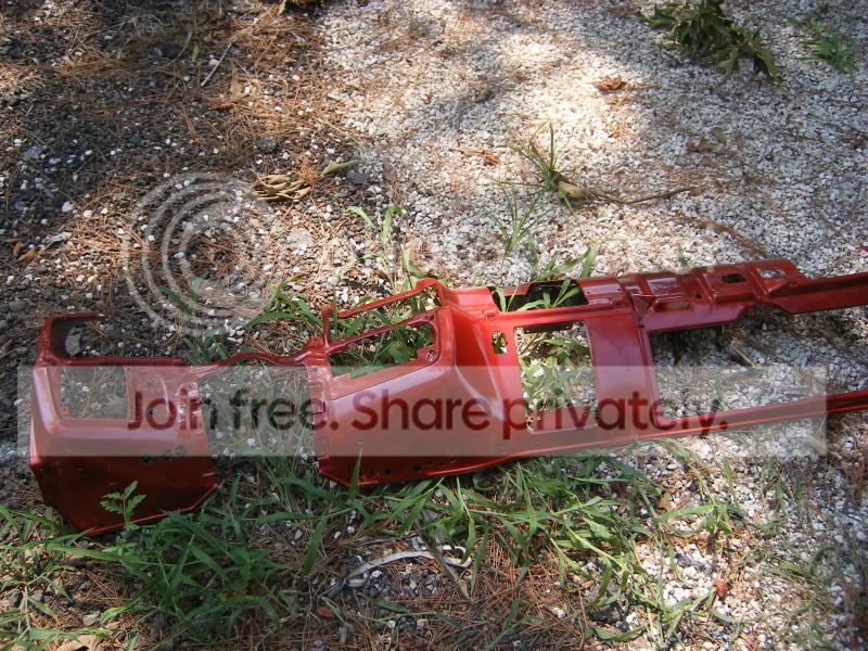

Fast forward to now, since then I now have a new place where I can work on my truck freely. I parted out a 6.5 equiped truck and was able to keep a few parts. Namely, the serpentine setup, turbo hardware, dash, steering collumn, a/c equipment, and wiring. Also sold the parts I had a while back for the 6" lift and decided to only go 4" with 35s instead of 37s but still mounted on h2 rims. Paint is still going to be GM color code 71 Sunset Orange Metallic mmmmmm sexy, but two toned with Artic white.

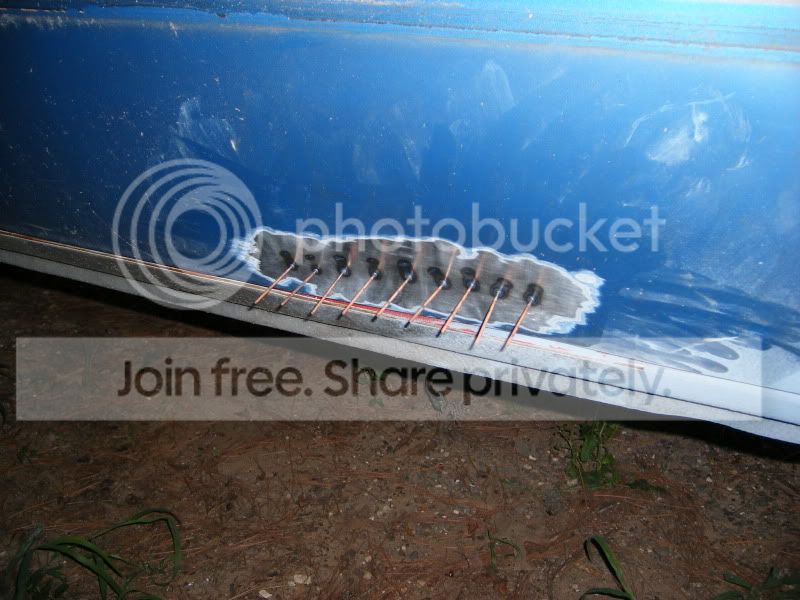

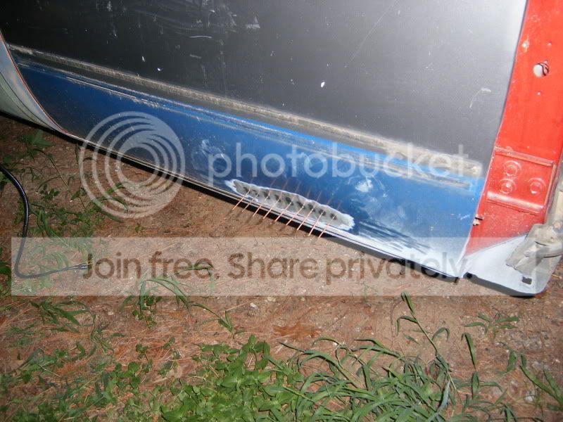

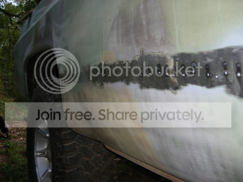

1) straightening up the body by pullng some dents out with a stud welder and slide hammer I just bought. Still need to get a spot blaster so I can clean out some small dents that my sander wont bring down to the metal.

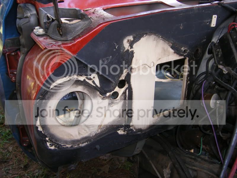

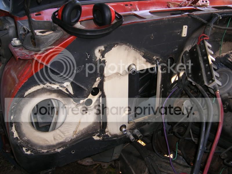

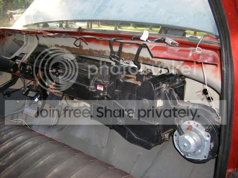

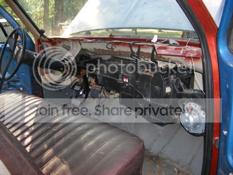

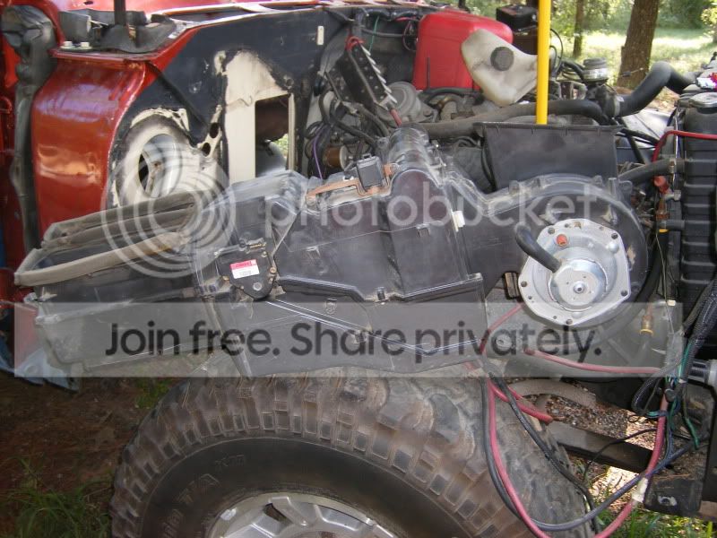

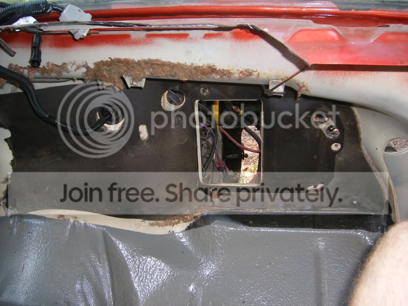

3)cutting out the dash and filling in the firewall on the passenger side and mocking up the dash and a/c hardware.
