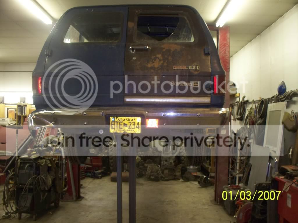

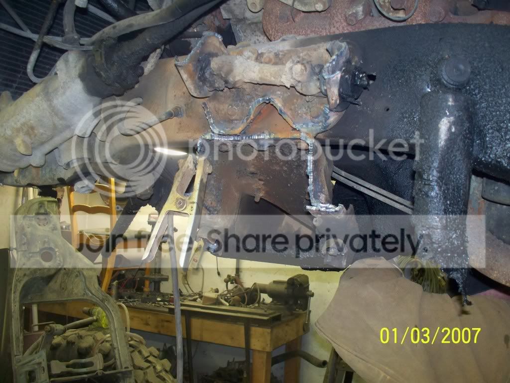

some odd damage we found

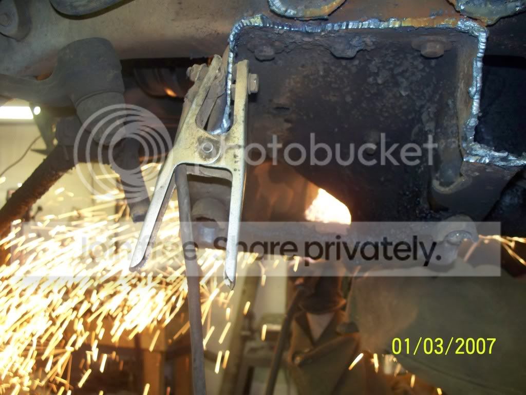

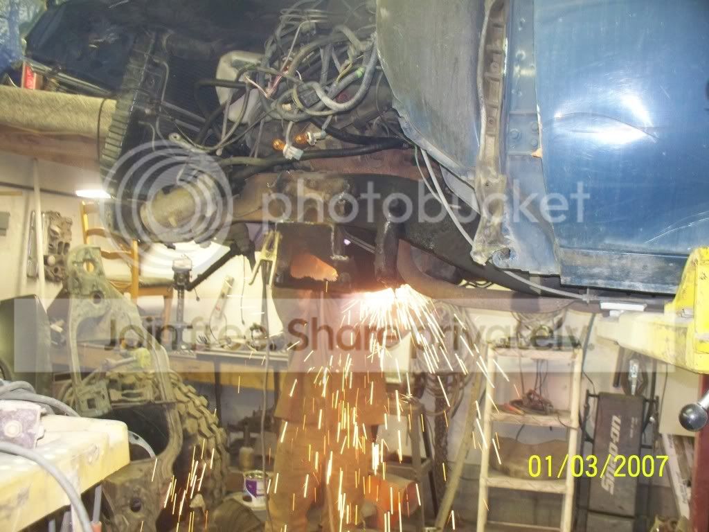

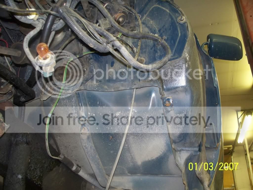

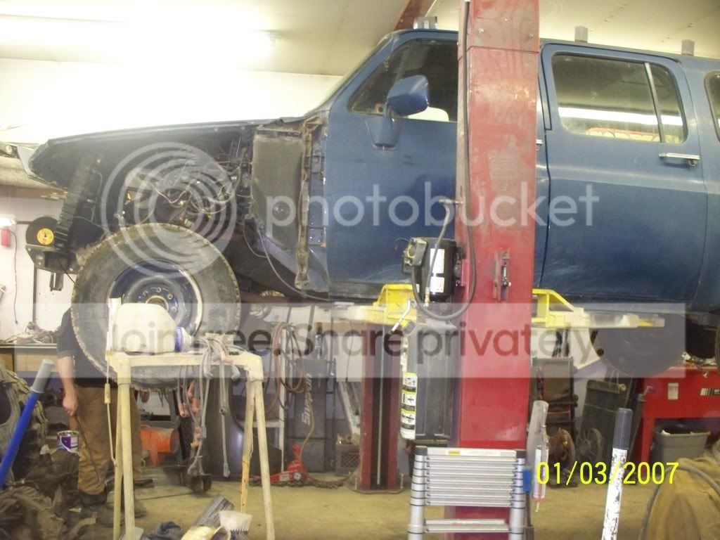

cutting the front end out

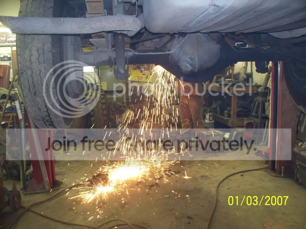

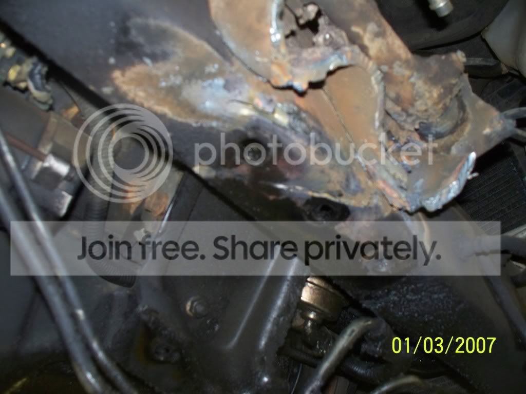

i think gus likes the plasma lol
maby too much lol

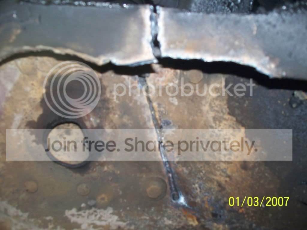

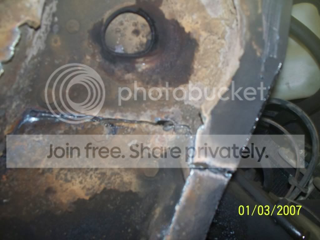

OPPS!!!

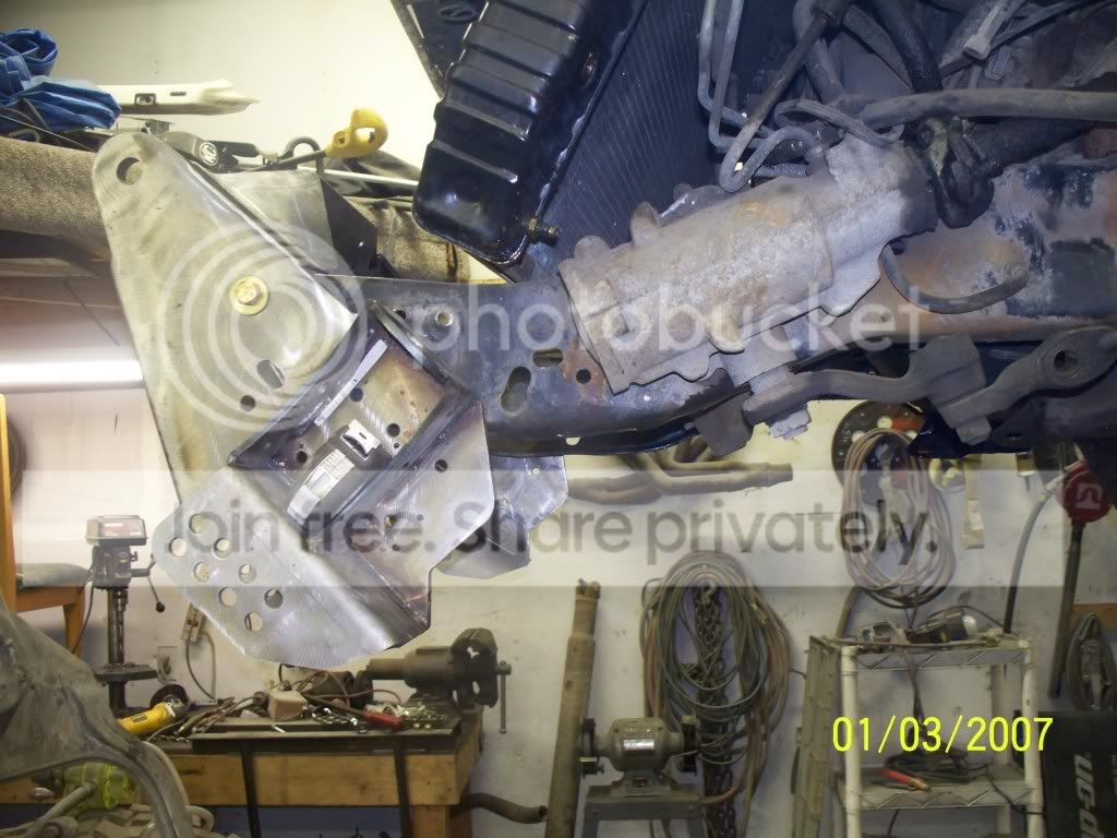

GOT A LITTLE HAPPY WITH THE PLASMA AND CAUGHT THE FRAME JUST A LITTLE BIT LOL

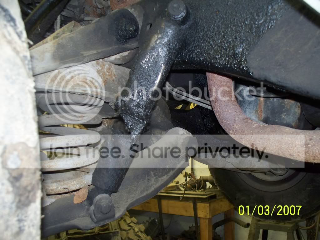

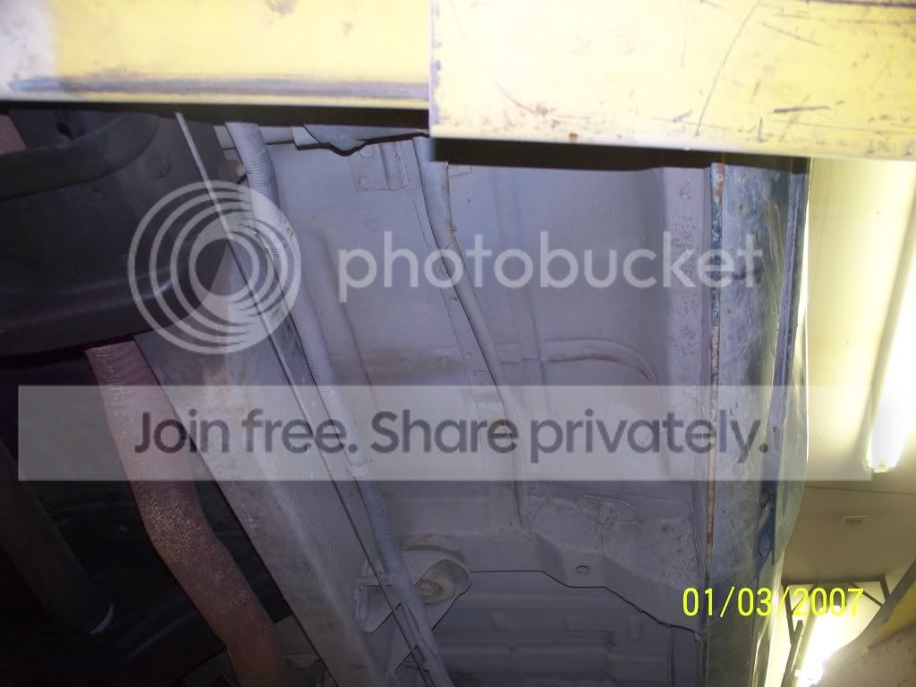

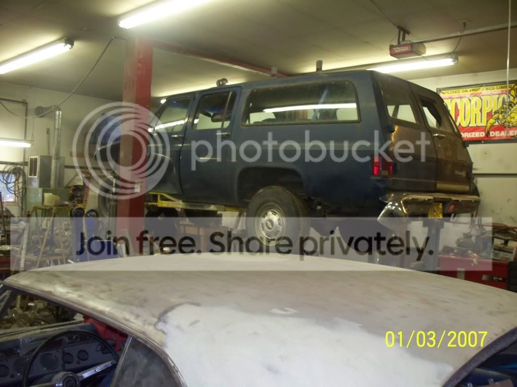

very clean underside.the whole rig is like this

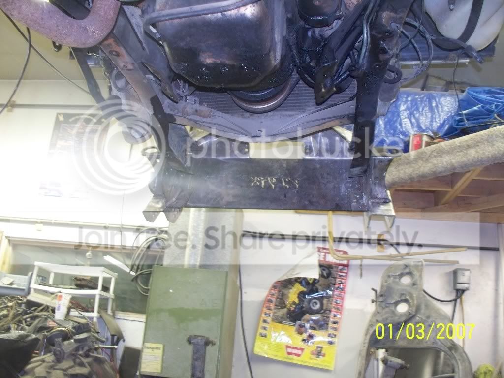

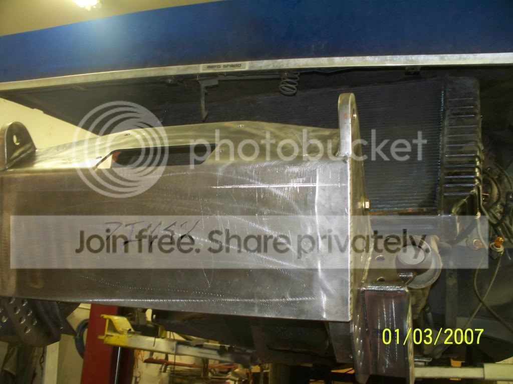

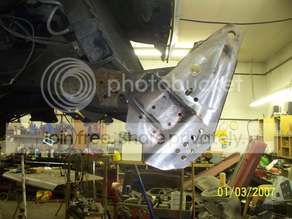

test fitting the abomb-very nicely built part!!!!

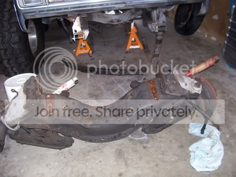

2wd suburbans are the best
PS: the front suspension comes out in one piece with about 12 bolts :D
lol yup it does but was much more fun with the plasma.besides gus never used one before and was having way way too much fun with it
That is most definetly the baddest winch mount/bumper/spring hanger i have ever seen. I saw the DIY4X logo on her but was unable to find it on the website.Who did you have to sleep with to get one? Or is it 2 seperate pieces you grafted together?
it is made as seen by diy4x4.it is the abomb with thefromt plate made for a 8274 winch and has the body mounts lifted to match a 2" body lift.
do to the owner forgetting that he wasstarting with a 2wd it doesnt quite fit-NOT diys fault- so we will be doing a few minor mots to it to make it fit this frame correctly.
yeah the A-bomb would have fit perfectly if I had put it on the truck I ordered it for I'm very happy with it the quality is top notch!!
