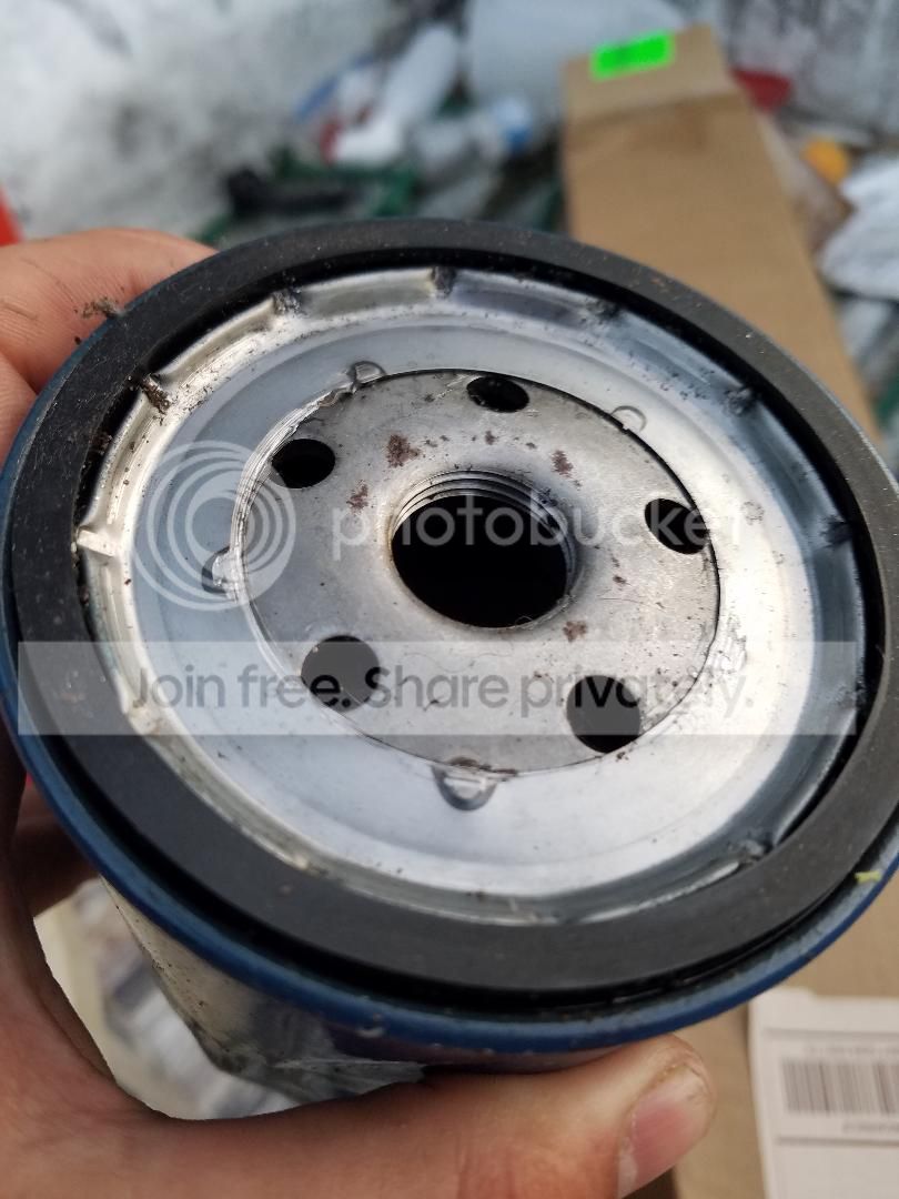

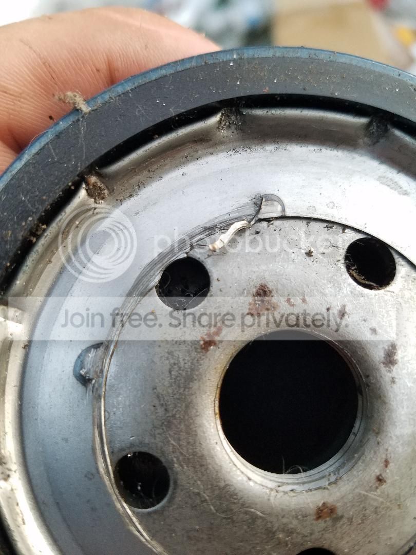

I was told the engine in my K5 was out of a 1991 2wd truck. My problem is the oil filter leaks, it doesn't appear to be the right one. It seems the right size but when i screw it on the inside of the filter hits one of the bolts before it seals . I checked both bolts and they are tight. The old filter was gouged on the inside where someone forced it on. I got a new one (WIX 51060) and it also hits the same bolt.

I suspect the filter is hitting the bolt going into the adapter at the block if there are scratch marks inside
Ill get a picture tomorrow. And yes I also believe that is the bolt it is hitting. The marks on the filter look to line up with the rear bolt and marring can be seen on the bolt.

What brand is that filter? I presumed you were using Wix by the part number. May be worth looking at that as well, this particular filter may be shaped different
Aside from the bolt, obviously
I think an acdelco because of the color but im not sure, it as no markings. It was on the motor when i purchased it. The new filter i purchased is the wix one I listed. Both filters make contact with the bolt head on the adapter.

Seems like that filter isn’t being made right. That top ring is way too big, shouldn’t be almost covering the holes like that.
Notice how the top ring doesn’t encroach into the center like yours are showing.
C9AAFBFE-2D52-4110-8A1C-43DFE93365DE.png D6EAC337-5890-48B2-B5F5-D8C7FEC43DEE.png
I don't think so. The filter i pictured isnt a wix one. I think it was an ac delco. It was on the truck when i purchased it. I put a wix 51060 on when i changed the oil and it leaked. I took the wix back off to compare it to the old one and thats when i noticed the damage on the old filter. The new wix filter also had a small scratch in the same place. I think the old filter leaked when installed so whoever put it on tightened it with a wrench until it stopped leaking.

You posted while i was typing. I does look like that old filter may have been bad. Maybe it was bad so they had to force it on damaged the adapter somehow how.
That adapter and bolts look 100% oem. I would bet lunch it’s something fishy with the filters.
Seems unlikely two separate brands likely purchased at different stores a couple years apart both have the same problem. But definitely a possibility lol.
