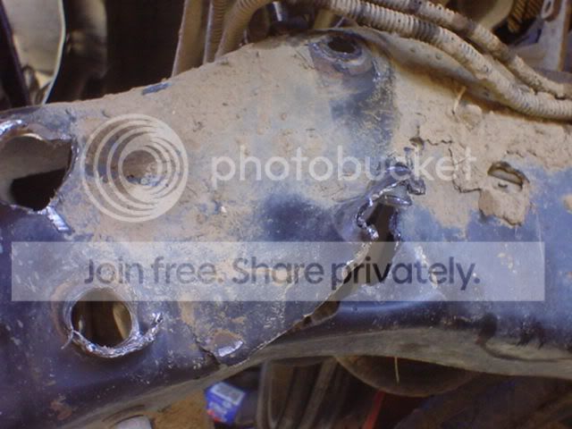

If you ever need a reason to strengthen your frame though here is my old 83. The box ripped out, flipped over and took out radiator. Frame horn bent down and took 8 hours to straighten up, grind out cracks and weld up, grind down welds and weld on a ORD brace, then bolt on a frame brace.
