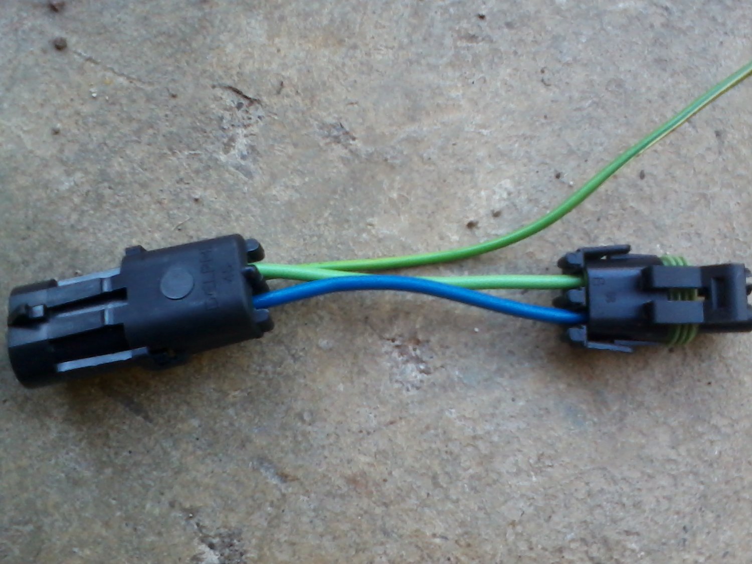

Adapter I made to feed power from the reverse light switch. I hate cutting factory wiring. It's a disease. This goes in between the trans reverse switch and the plug that normally connects to it. The one green wire going off picture is what feeds power to the camera/signals the mirror the vehicle is in reverse. I'm sure the reverse light circuit is fused somehow, but I'm going to run that power wire through the auxiliary fuse panel with a very low amp fuse, just in case.

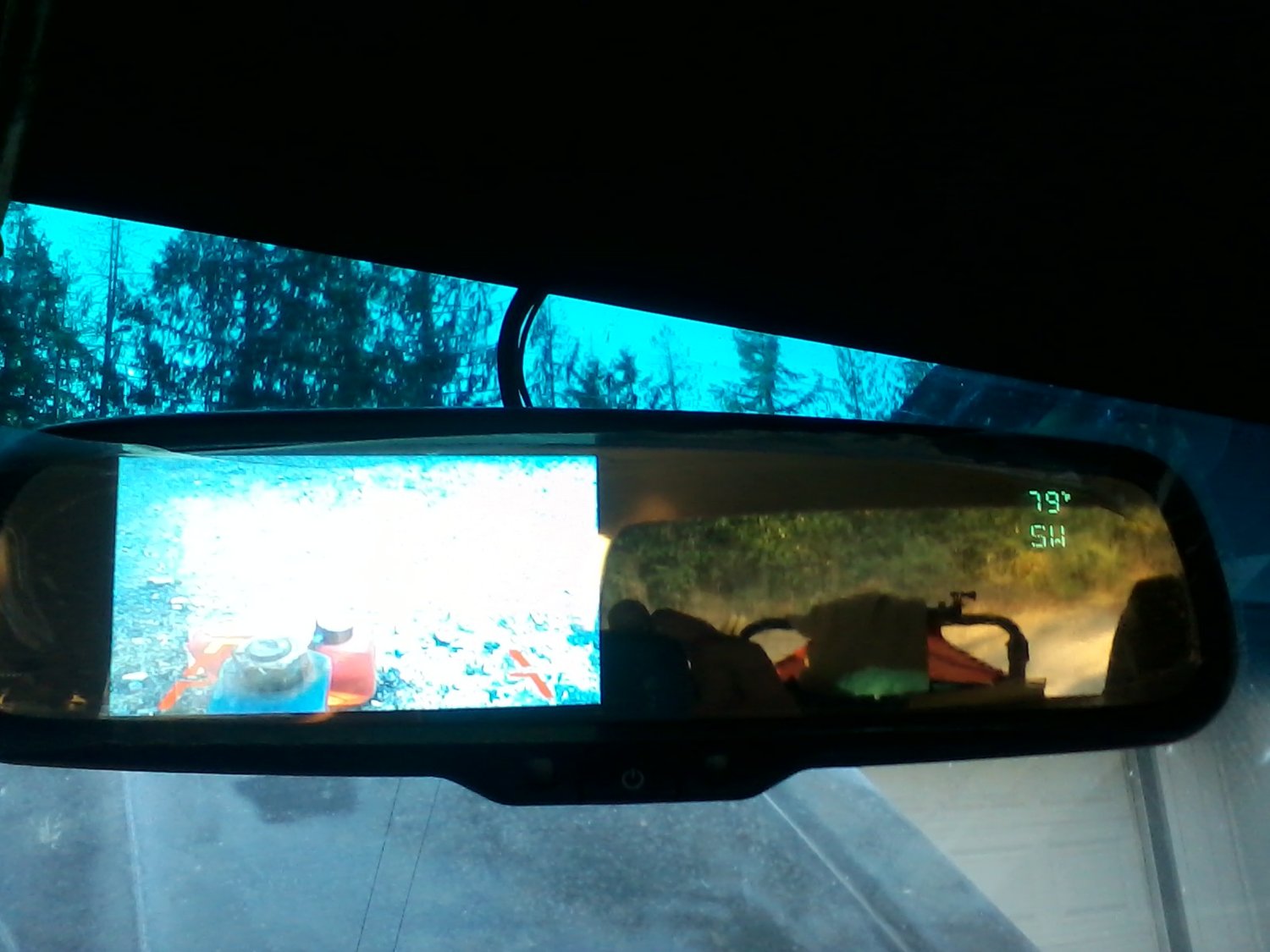

My phone sucks, but this shows the mirror "on" (temp/compass) and the camera image, as the trans is in reverse:

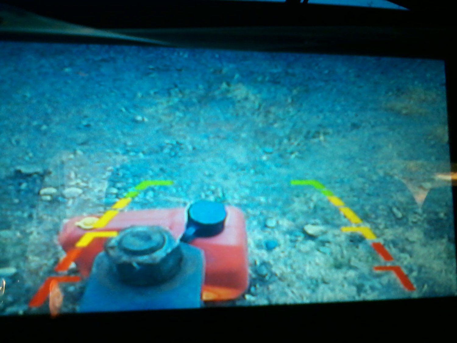

Closeup of the camera image in the mirror. That is where the ball would be, but this one is mounted upside down on the stinger. That's a very small gas can, not a 5 gallon one. :) I mounted the camera up against the license plate as close as possible so that I'd get more viewing area. It does not obstruct the license plate, there is a fair bit of space above the plate. Camera has to be offset here because the license plate light is dead center and hangs down too far to put the camera under it. BTW this is supposedly a 170* camera, which appears to be the widest common (read: cheap) angle. I could bend the camera down some if needed, I'll wait and see what I think of it in operation before I do that.

Still haven't removed the protective clear plastic off the mirror, so the pictures I took are probably a bit degraded because of it.
I'm thinking I can probably remove the backup lines in the image since this mirror has two inputs, one from a rearview mirror camera, and another generic input, I guess in case you wanted to watch microscopic movies while you were driving? Would be cool to display some of the ECM data on there when testing a tune I suppose. As the lines can be moved around on the image with the mirrors remote (yes, it has a remote lol) I'm guessing the generic input won't have lines. Both inputs use the same RCA type connection.

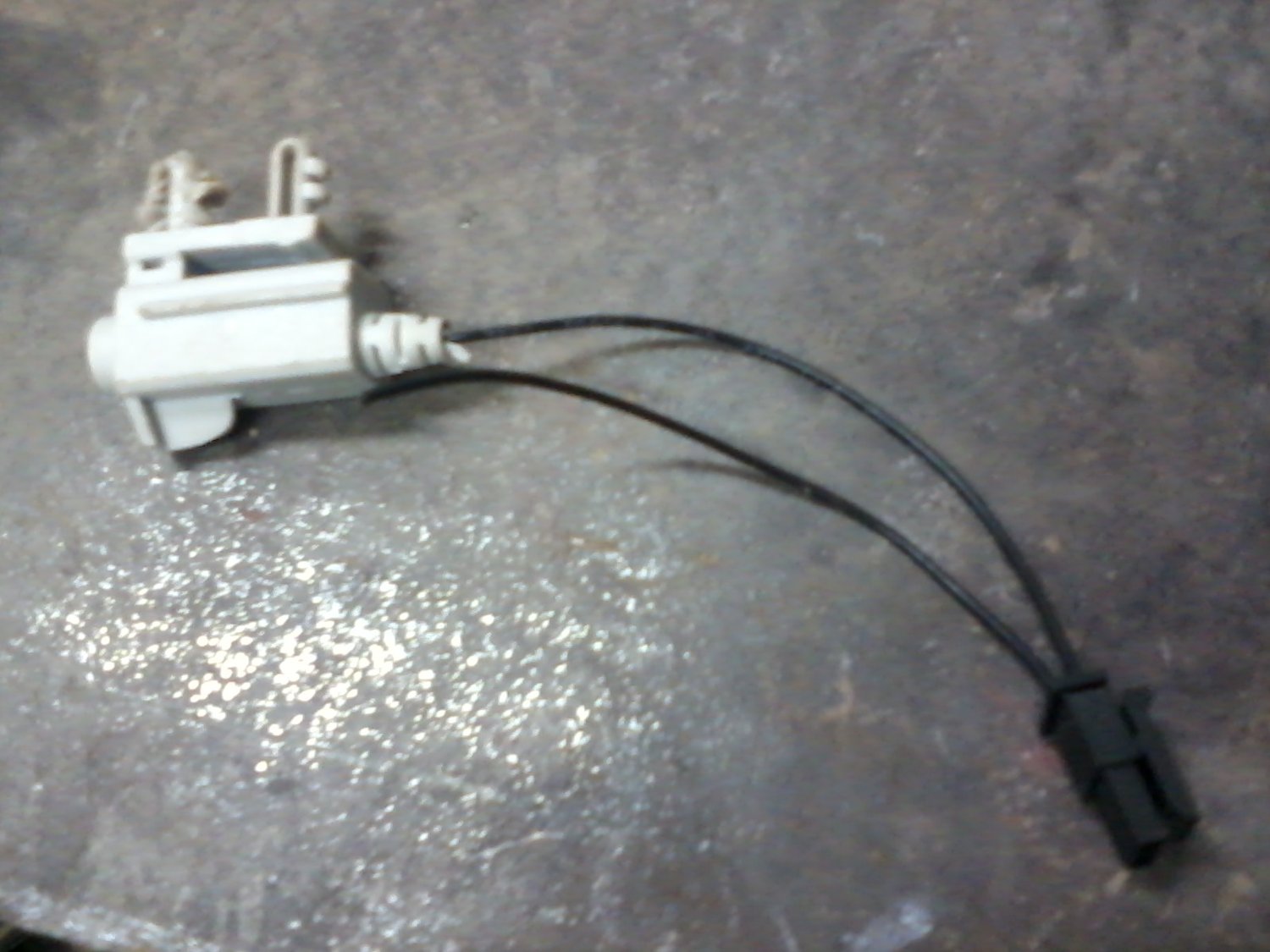

Oh, had this pic too. It's the temp probe. Drill a couple of holes, clip it onto a flat edge somewhere, or make a bracket and drill holes in that to mount it like I did. You can see the one wire is broken right at the probe. These wires are flexible, but springy. Not sure why they made them this way. I looped them back on themselves in a decent arc, and cable clamped it to hopefully take the load off the wires as the vehicle rattles and vibrates, and in case somehow the wiring connecting to the plug accidentally gets yanked on.
