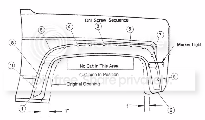

Anybody use the cutout flares? I am not a fan of flares, but dont want the unfinished look of trimmed fenders on this burb.
They want you to run 9's. I run 8's because its easier to keep a bead when there deflated. I dont have any eperiance with the cutout flares but it looks like(google images) that they would work. You may have to trim the inner front portion of them. You should also have EZ inch blocks in the from moving your axle 1.5" forward. 40s wont fit without being moved up.

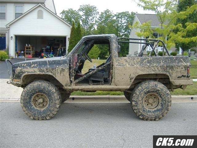

I run 39.5x15 TSL's on my K5 with a 4" lift and axles in the stock location. It took a significant amount of fender trimming on the front fenders to make them reasonably fit for off-road use. The rear of the front fender opening is cut back to probably 2" of the door opening along the bottom edge along with the inner fender being cut out in front of the firewall, and modifications to the firewall itself. The front "fangs" on the fenders need pretty good trimming for turning. I had previously run 13/38-16 TSL's, which are closer to 37" tall and pretty skinny, on the same 4" lift with slightly trimmed fenders and couldn't even get it turned out of the garage prior to trimming.
The cut-out style Bushwackers do provide more tire clearance but I really don't think they will provide enough for 40's with 3" of lift.

The cut-out flares have you cut 1" of fender at front and back, which adds more like 1.5-2" on the back of the opening, since the rolled lip is removed with it.
You can't go much further than this anyway, without removing or modifying the inner fender. You can cut away more in the front, though, so moving the front axle forward helps in fitting big tires. I have these flares, with close to 5" of lift and the front axle moved forward 1". It clears 38x12.5 , but I have cut additional material on in the front inside opening. I can't see 40's working with less lift, especially because they will be like 15" + wide. Some have tried to cut more than the directions indicate and pull the flares out further to fit, but they really don't conform like that.

4" Tuff Country HD, 39.5x15 TSL on 15x8 2.75"BS wheels. I did say the bottom edge of the fender was about 2" away from the door opening...it's not in this picture but the rockers and bottom of the fender is cut out about 6" higher than stock, so prior to that it was about 2".
