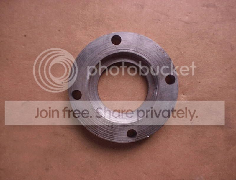

there is another way. these are what will be going into my 1-ton.
dana 60 yoke welded to a custom spacer, then bolted to the existing flange on your t-case. this is not my idea, there is another thread on here about it.
i also like getting more clearance for the d-shaft with moving it forward out of your setup.

I would like to see more info on this. I have a set of 60 stubs and I plan to make mine out of square tube so all I should need is the custom spacer.
one side is machined to fit the flange, the other side is sized to fit the cut off stub. it is .70 thick.
it's actually 9" slip. probably 7" usable. i have yet to build this shaft yet. altho i do feel this will work ok with my 52" springs up front.
