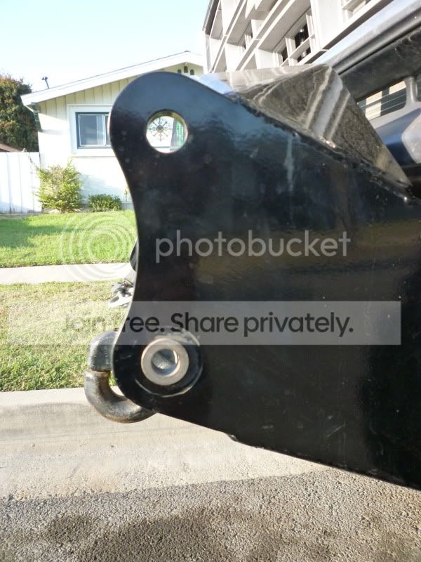

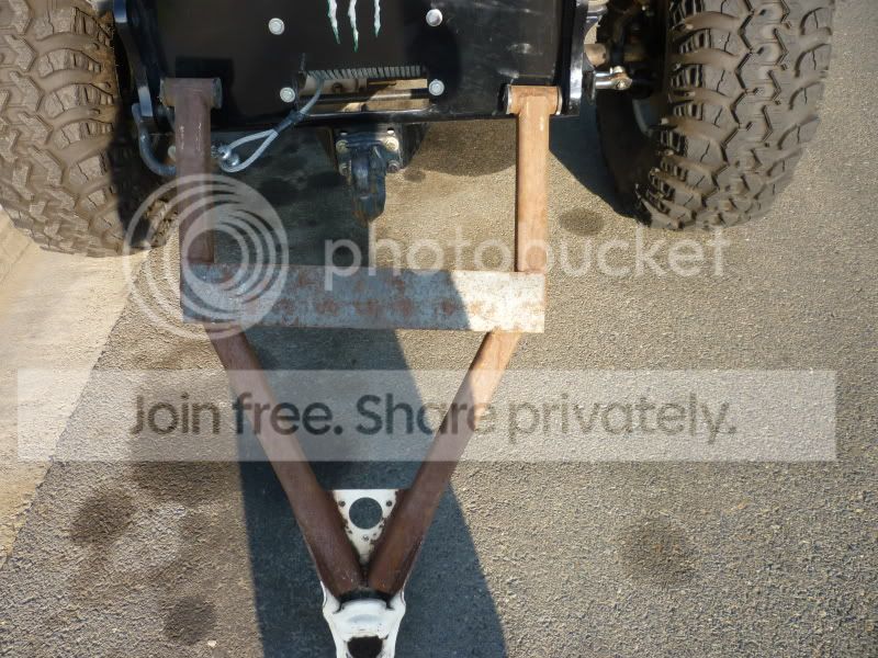

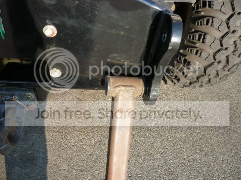

I built mine out of 2' square tube and use a 2 5/16 ball not a 2' ball as standard trailers are. It uses 3/4 bolts to hold it to the truck, i had tabs welded to a piece of square tube in the frame rails but removed it when i installed the a bomb. Know i just bolt it to the a bomb with 1' to 3/4' reducers. I also use big safety chains there is pics i posted a while back ill try to find them

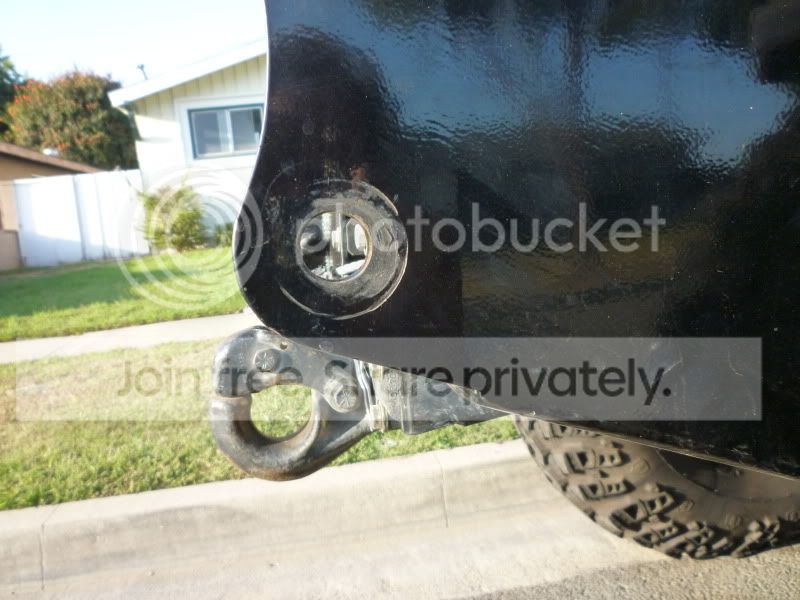

i have mine set up single sheer now on the a bomb.
before it was tabbed as you have it drawn. I used the builder 1 3/4 bushings for the attachment point on the rig.

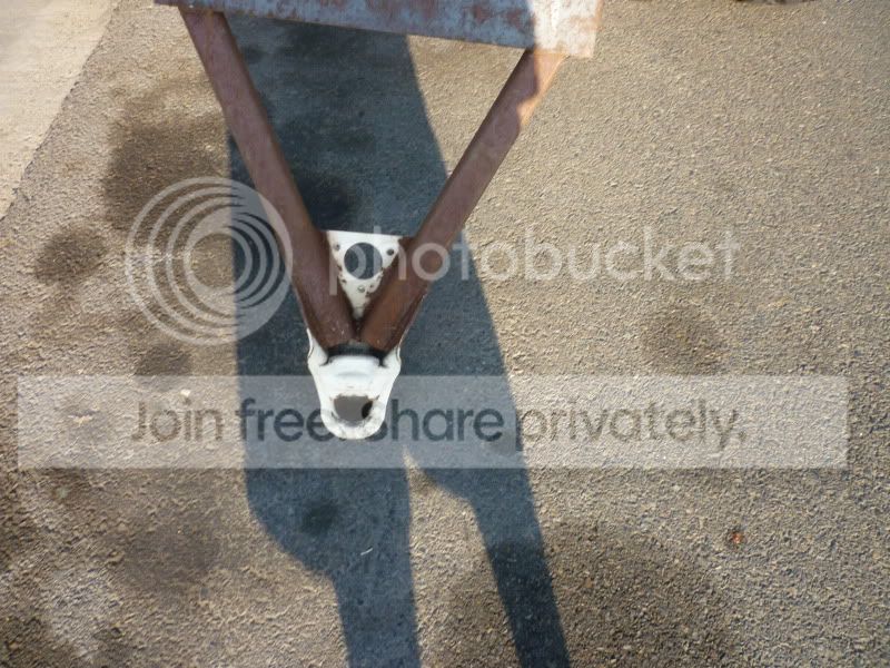

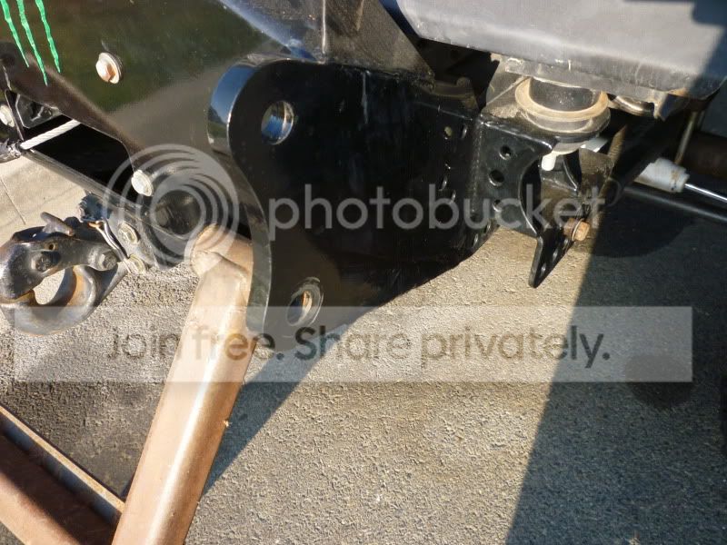

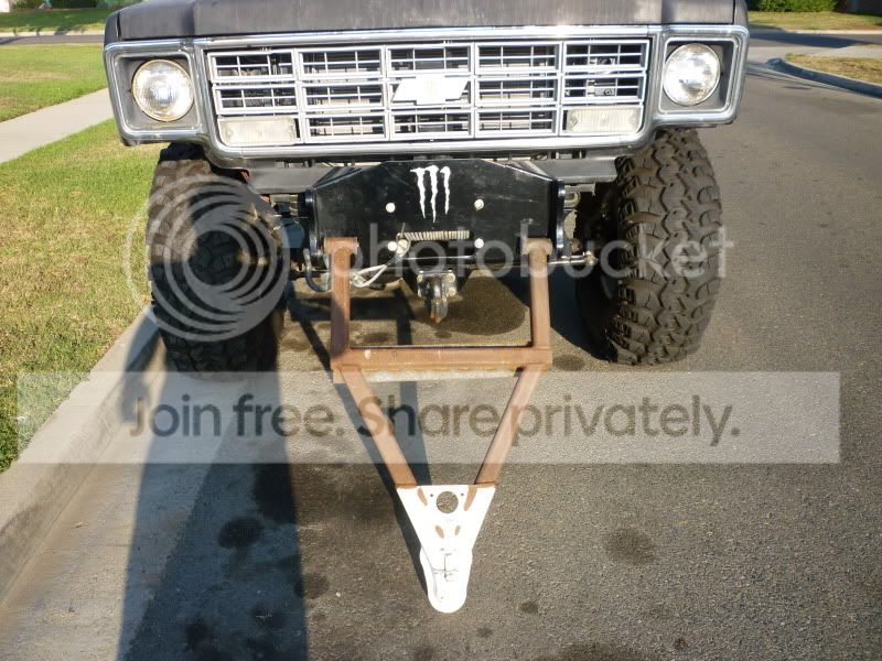

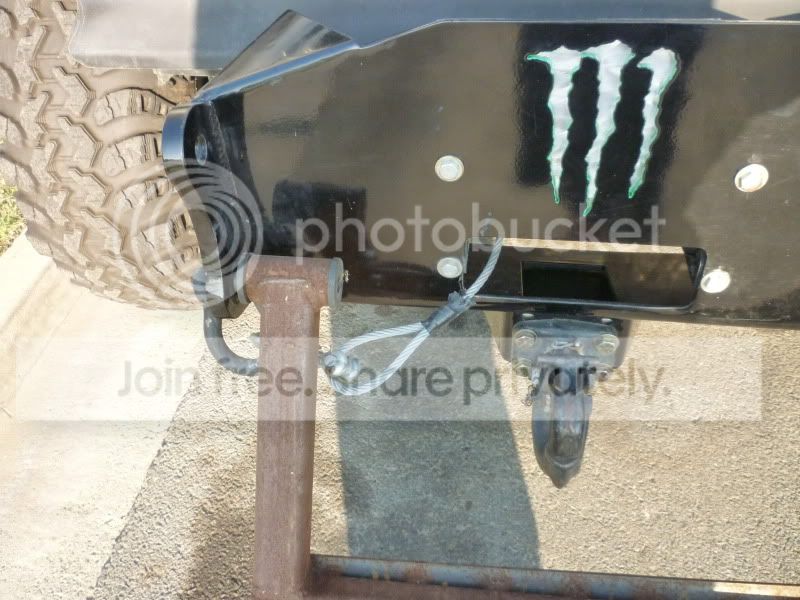

Here is the pics.
tow bar leaning on rig.
upside down so you can see the underside.

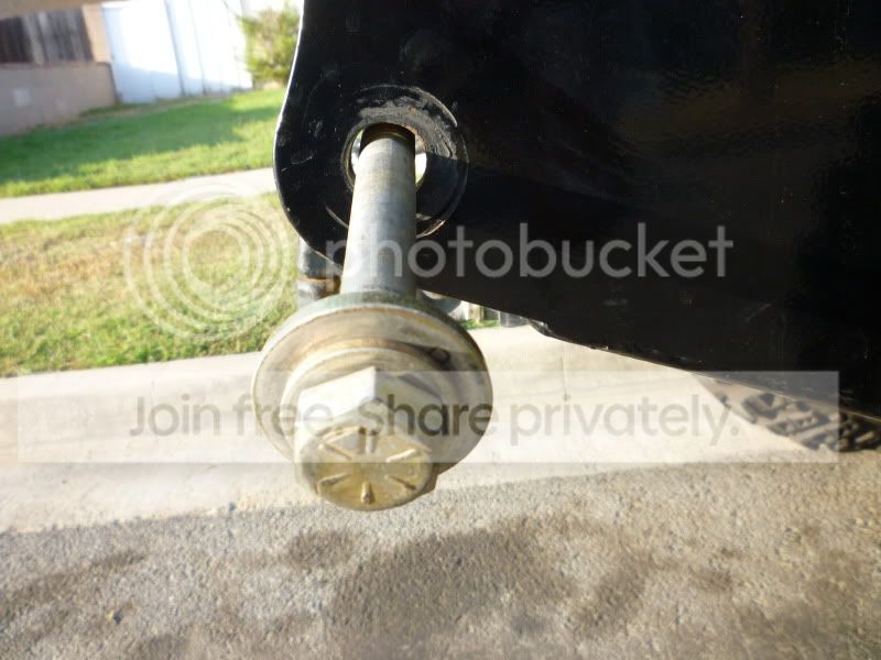

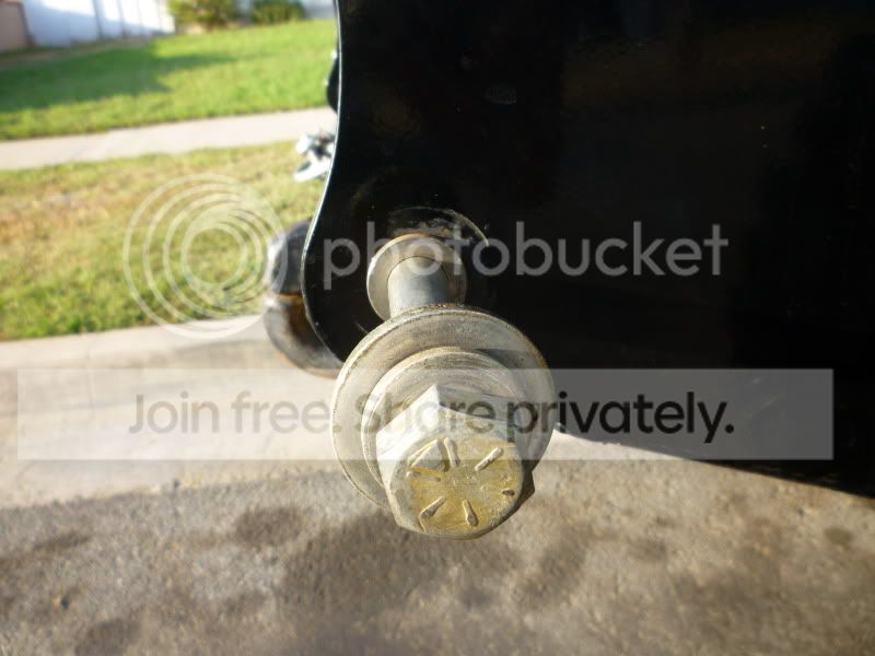

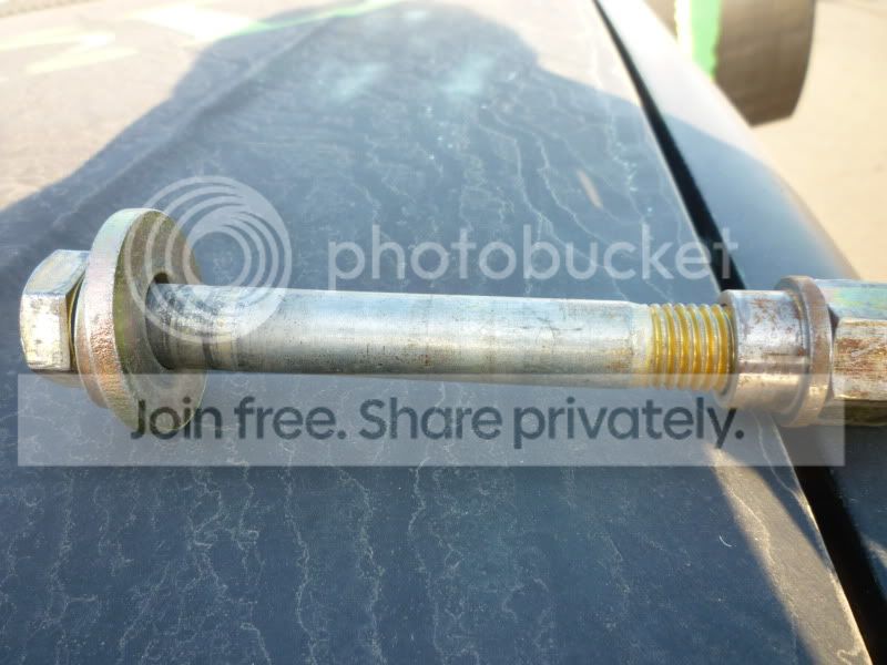

bolt and spacer or reducer.
without reducer
reducer installed
reducer ands bolt
