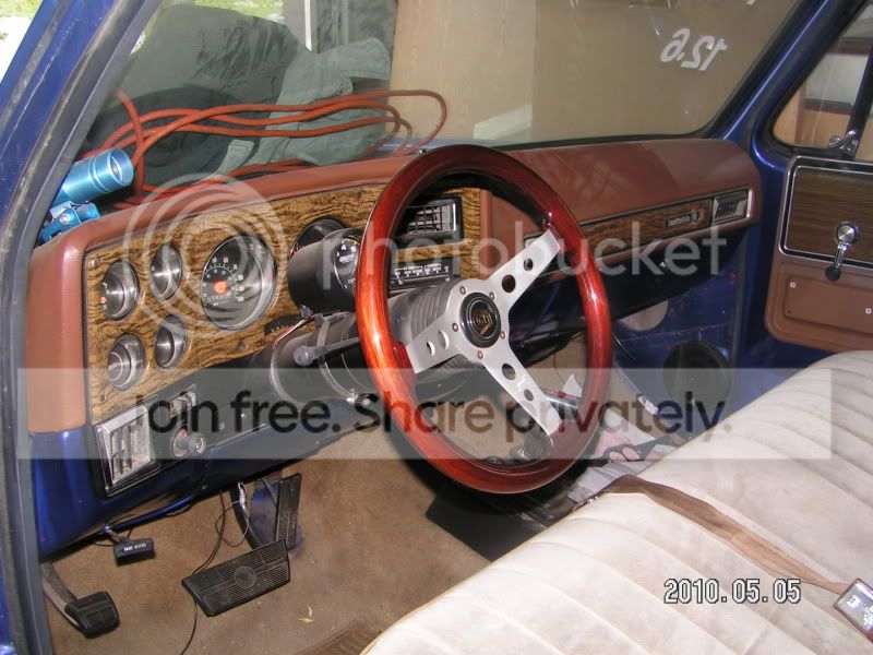

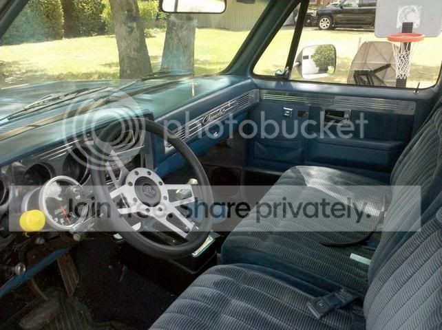

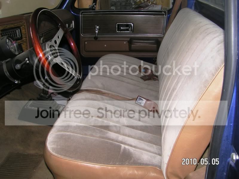

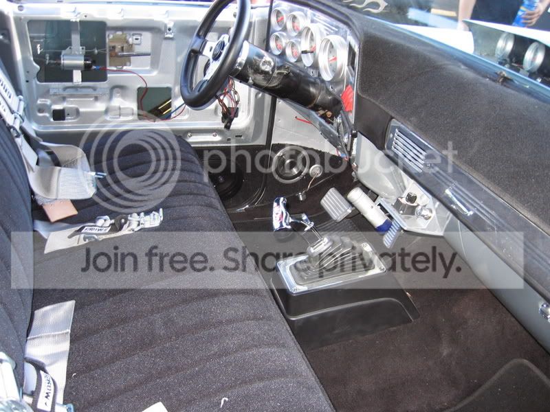

I found these pics on 67-72chevytrucks.com-
The first two are the shorter standard base, the second two are the taller truck base-
