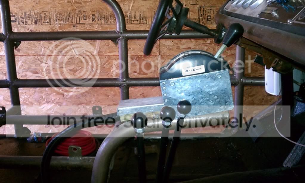

I have my AC shifter installed straight to the floor in my truck and my seat tops sit a little higher than the top of the stock center console. It wouldnt be hard to mount it a little higher with some longer angle iron or something. But Boz42's setup is probably the way to go if I was going to keep it in the truck. :waytogo: I had to throw mine in as a temp emergency fix right before I left tdy. My tilt column self destructed on me right before I left and I was right in the middle of a unit move. Had to have some way to get to and from work the last couple of weeks and to be able to move the truck around the driveway while I am gone. The only replacement column I had available was the one I picked up from Icehouse for my manual 465/205 swap. I ran it this way for a couple of weeks and liked it. I like the AC shifter so much that I would seriously consider not swapping in the manual trans and staying with my 700r4. But then I drive my truck around a bit and realize the transmission is going to need so much work that I am better off doing the manual swap since I picked up all the parts.:doah::D

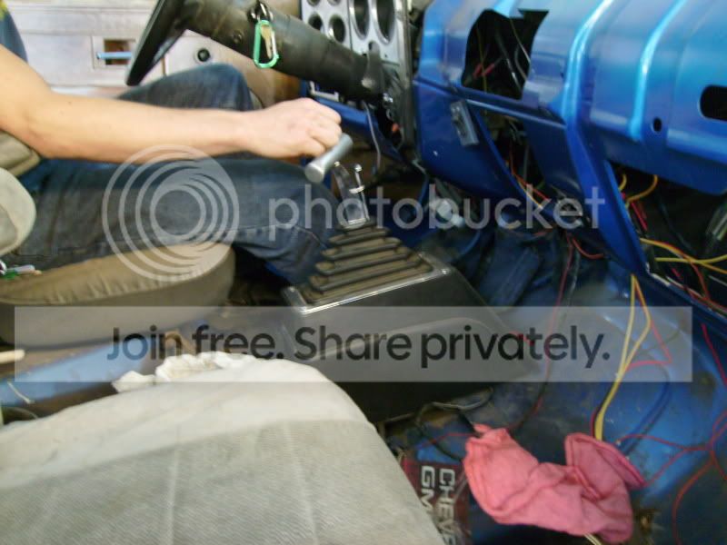

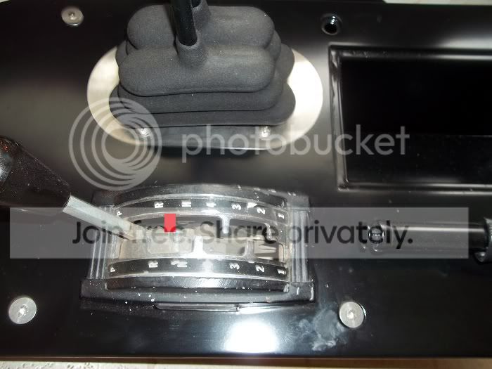

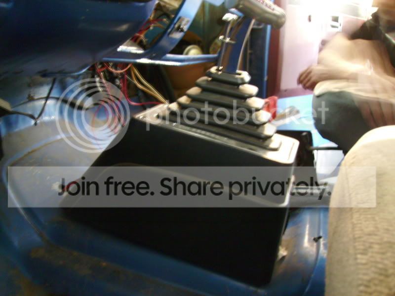

i got the one that clamps to the tranny and is 1 shift rob no cable . it was set to fit in my stock 4 speed hole from my old 465/205 combo. even with the boot on it it fools lots of people.
pic 1 = shifter in park
pic 2 = center shot in park
pic 3 = simple hiem joint linkage rod 1 little s bend needed
pic 4 = all the way in 1st gear still lots of seat clearence

and here's a gated for a 700r4... i put a red spot where it had a gate... just makes it much easier to street drive with the one gate not there....
Art Carr is out of business but Winters Shifters made the Art Carr shifters and still sells ones just like them. I run an Art Carr shifter in my Chev.
b&m mega shifter for taller truck use was o.k.
but the rubber boot dry rotted vary fast. and the unit was just kind of chinsy i think for the prices.
lokar has lots of options even a cable adaptor for stock colume shift linkage replacement.
and i have there 23" long blacknight 2 bend on my th400 with pistion shifter knob on it.
i like it real good. good quality and shifts good felling wise. and the 23" long handle is perfect placement just like a 4 speed shifter.
