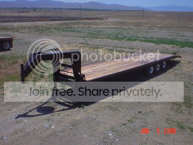

This is my old trailer I got for $600 and rebuilt. Worked good but was heavy (6,000 lbs) and the triple axles scrubbed bad when maneuvering. I sold it in favor of a 18' bumper pull but it is mostly for my offroad rig and taking that big trailer up the mountains and such wasn't the funnest. I sold it and made a decent profit.
