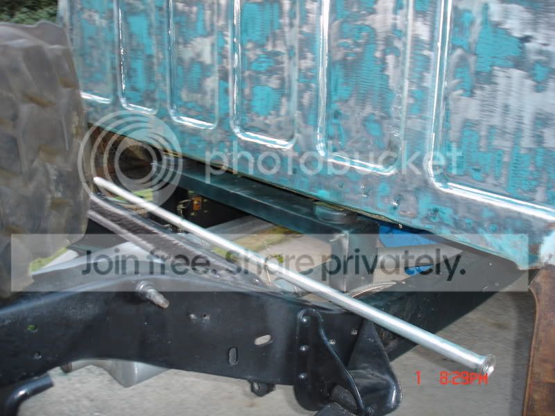

Cage it. Mine is going to be built in just a few weeks. So its still all top secret until it gets done... :) But heres a pic of the rear cab crossmember I took last night.
