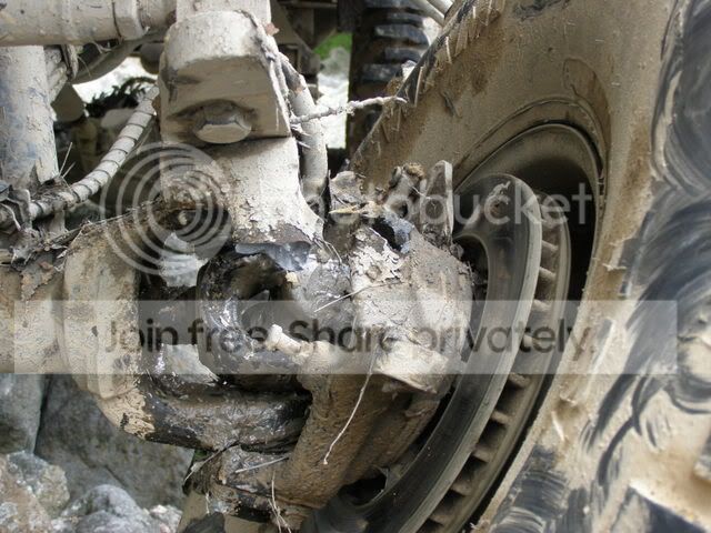

Um....Yes
And yes....It was a pain to get off the trail. One of the other rigs went back to the trailer and took his off and we switched with mine.
