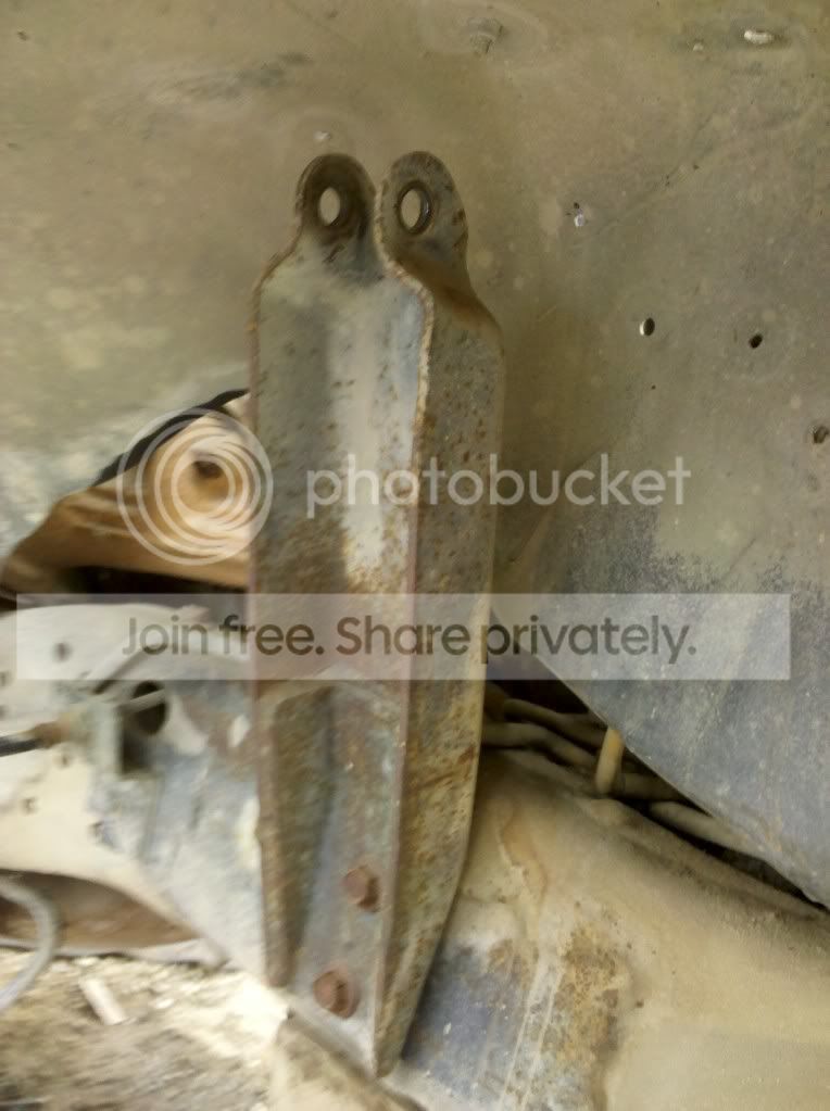

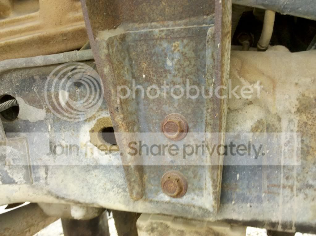

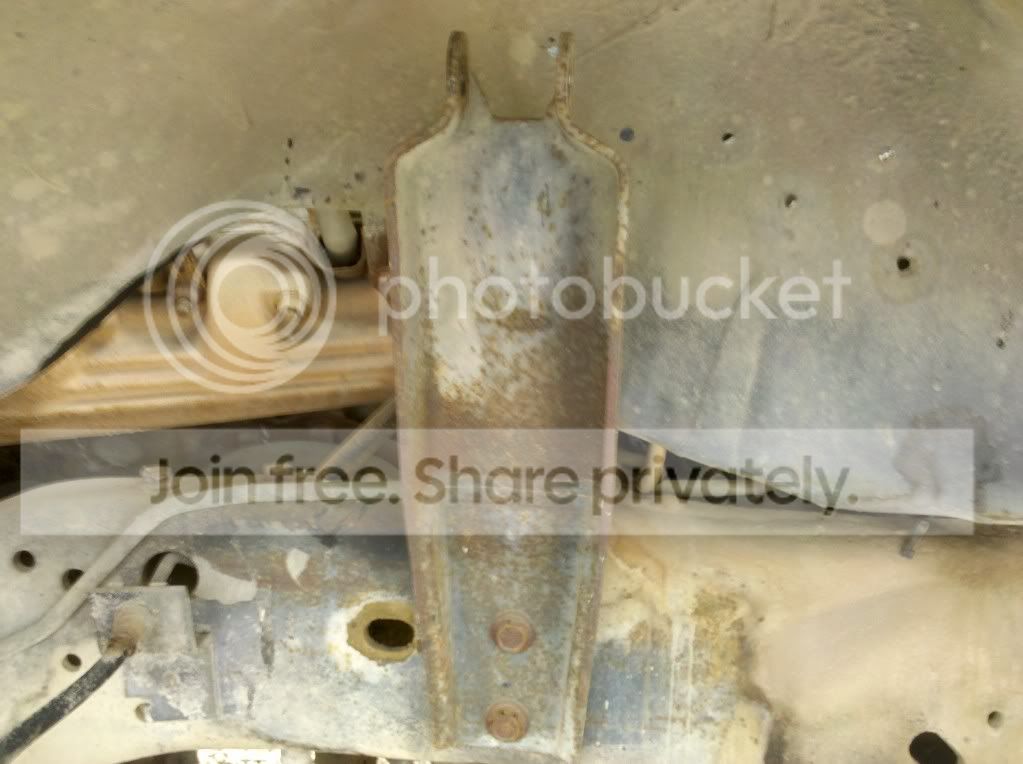

Ok guys, I'm thinking of going to the junk yard and grabbing some towers. Are they bolted on these fords? So, they are kind of easy to take off at the junk yard? The cast ones look stronger but they are single sheer. The way I drive this beast, I don't know if I should go that route. I made some time today( with the wife) so I need to get these. Are the stamped ones strong enough for me? Thanks guys!
The stamped ones are on the Super Duty and should be beefy enough. One thing I found with my stamped ones I went with up front was that the shock post is slightly angled. This put more stress on the shock bushing as it did not sit perfectly straight. I never had any problems with it and the bushings held out fine but they will probably need replacing sooner than if the bolt sat level in the shock bushing. I had planned on swapping in poly bushings if the rubber ones ever cracked, which they hadn't yet.
I went to the junk yard, and found a good pair. I couldn't get them off though. The bolts would not break loose. Demmit!! Its a beefy mount. On the bottom it was reinforced. It was on a 2wd dwr. I am going back soon.

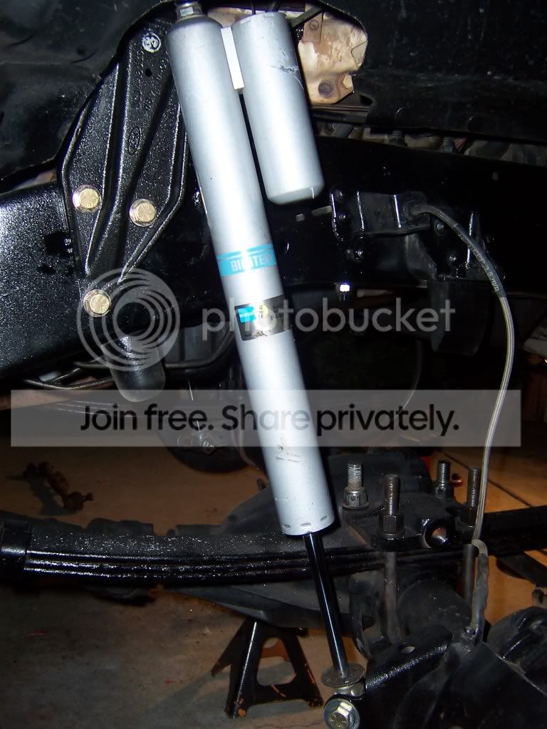

I mocked up several options for my front shocks, considered the Ford towers, and finally said to myself i may as well build something better, more reinforced and that puts my shocks exactly where I want them.
I did this:
Rene
Ya, that is sweet! I just don't have the time for that. I need something easy and fast. How much do you want for that? Ship it to me! What's your paypal?
Is it normal for the fords to be reinforced on the bottom? I am going back today with bigger tools.
