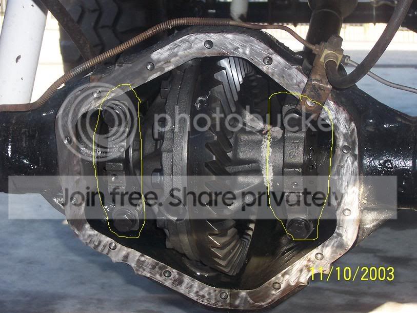

  6. mo
    mo 1/2 ton status
    Joined:
    Jun 29, 2004
    Posts:
    542
    Likes Received:
    Location:
    Folsom, CA
  7. K5MONSTERCHEV
    K5MONSTERCHEV 1/2 ton status
    Joined:
    Jan 27, 2003
    Posts:
    3,254
    Likes Received:
    Location:
    Castro Valley, CA
    [ QUOTE ]
    is that the kingpin bearing caps? I think parts labeled 44, 52 on the diagram at http://www.pirate4x4.com/tech/billavista/60_front/
    thanks
    [/ QUOTE ]
    The bearing caps. The things circled in yellow. If it doesnt have em, its no good to you.
    [​IMG]
