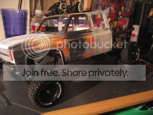

that looks way cool!! Always planned to build such one, but never had time for it. Tell me more about it! Looks you took a Bruiser/Mountaineer frame and extended it. Are the leaf springs from the Tamiya truck series, or from eht new Ford F350? Tires are from the XB-chassis, Wrangler or Chevy S10 and Hummer wheels. Body you took from Clod Buster, but how did you make the cab? Absolute cool, keep us up to date with your project!! :waytogo: :waytogo:

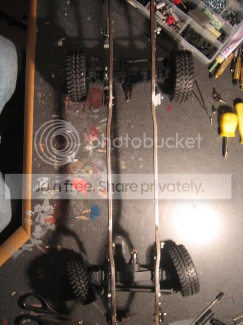

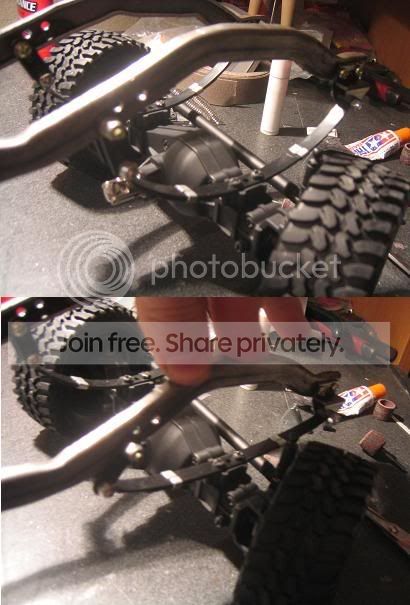

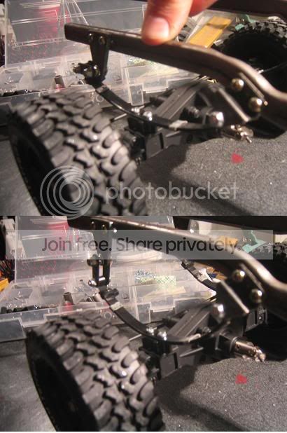

its a homemade frame out of 1/2" square tube cut in half and the springs are from the 350. tlt axles and shocks and two clodbuster bodies joined with styrene and alot of work and filler. i seperated the bed from the body and built the backside. tires are bfg mud terrains tippin on 8 bolt hummer wheels. it'll have the k30 treatment with all the lights and emblems. ill post more pics if yall wanna see more.
on the first view the frame looks to be from a bruiser, but yeah, now I noticed the difference. I had the same bfg tires running on my Tamiya Hilux, looked also quite scale. Please keep the story alive, I'm very interesting to see more pictures!! Will it be radio controlled? If so, what gear box will you use? Hilux, Truck series, or from the Ford 350?
well.... i guess. its only a bare frame and a cab right now, its still in progress and will be for a while. 1:1 is getting a new set o axles. heres the pics:
frontal flexage
rear flexall
obligatory flex shot: (no weight yet)
and frame:
update
