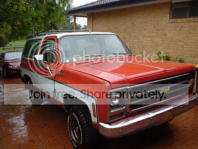

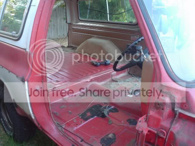

As bought
Interior

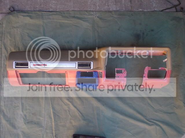

I was wondering, anyone know how many K5's were produced in a righthand drive and exported across the pond? Or was this a dealer installed feature?
hunterguy86 said:
Sounds like you have an awesome project going there.

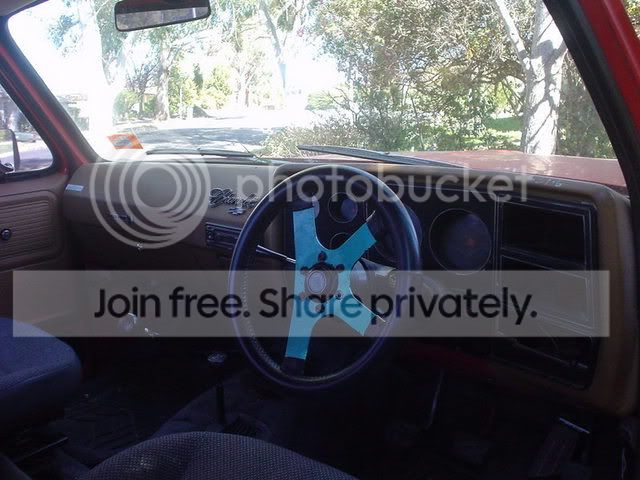

Yeah, I did a doubletake :eek1: when I saw it was RHD!
I see the gauges are in the same configuration, i.e. not mirrored, but the dashpad is mirrored, so GM at least had to supply parts.
AussieK5, what's in the center of the dash above the 4x4 shifter, is that a radio or something?
what about the heater???? when they converted it did they not re-install the heater???? or does it even get cold enough there to worry about it ???? also does it have a NP208????? it kinda looks like it might be a 205.......More pics please

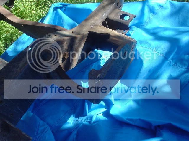

Just think of the backwards looking steering box that is now mounted to the other side of the rig.
Actually, looking at
http://i90.photobucket.com/albums/k260/llebnosaj/frameoff.jpg
it looks to me like it's the same box, but they put it outside the frame on an inside-out bracket thing ... eww. THAT'S gonna cause problems... and you can't exactly use the ORD brace, you know? :doah:
WOW, i just looked at that pic and the front end of the frame looks all whacky like that being offset. Another one of GM's super bright ideas

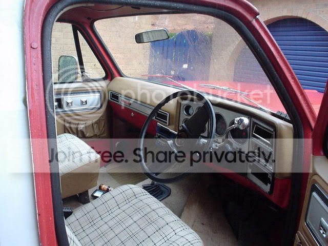

GMH (Aussie arm of GM) assembled a few thousand C20's and some K20's. They are all Aussie complianced and have factory fibreglass dashes installed. As far as I know not one K5 was complianced by GM and all K5's in the country are imports. The dash out of my K5 was originally from one of these C/K 20's. The dash pad is not a usual feature of the C/K GMH built and is a add on. This is the dash in my 79 K20. Sorry the image is a bit dark and my Photoshop prog recently crashed.
That 'thing' is one shagadelic blue'ish shagpile stereo/CB mount. The wife wants me to leave it in because its so corny its almost cool. I'll be giving it the heavo ho!!
The heater box etc was in place on the left side when I bought it, but is was damaged so I panelled the holes in the interim. I definately will be installing a aircon/heater as the temp range can dip to 16F and hit 120F. Not as low as you guys but still damn nippy.
Actually all the problems with craked frames disappear with this outboard box. Its constructed on 3/8 plate and mitigates points loads on the chassis. Its an simple well engineered solution. My K20 has a frame mounted p/steer box and it flexes like a b%tch. Both K5's Ive owned had this mod and both frames are pristine still. I should mention that although this 79' has done little work my previous 73' had metal fatigue issues all over, body and frame, but the p/steer mount was not one of them. I would not fit a frame mounted RHD box. The turning circle is great. A bonus is the LHD boxes are almost free down here as they are about as useful as a c%ck flavoured lollipop in a RHD country!

Wow ... I take back my fears about the steering box -- that pic of just the plate ... wow. 3/8 plate :eek:

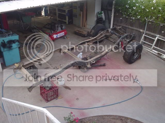

This is a older pic as I tore down the vehicle 6 weeks ago and boxed everything under the house. You should be able to see the knuckle/arm (the arm is a custom) and tie rod, this connects to the pitman arm in the usual manner.

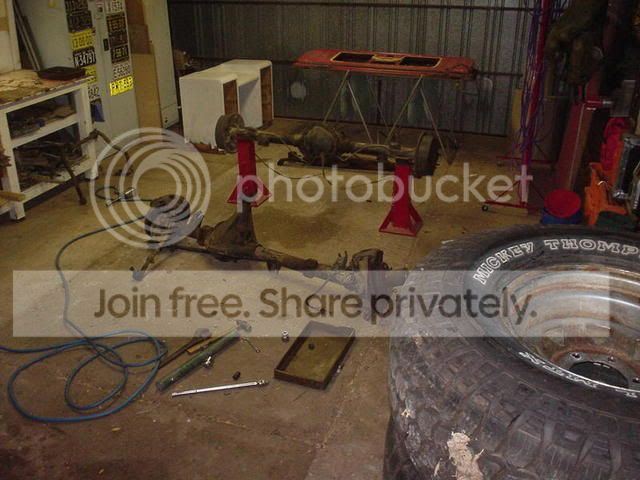

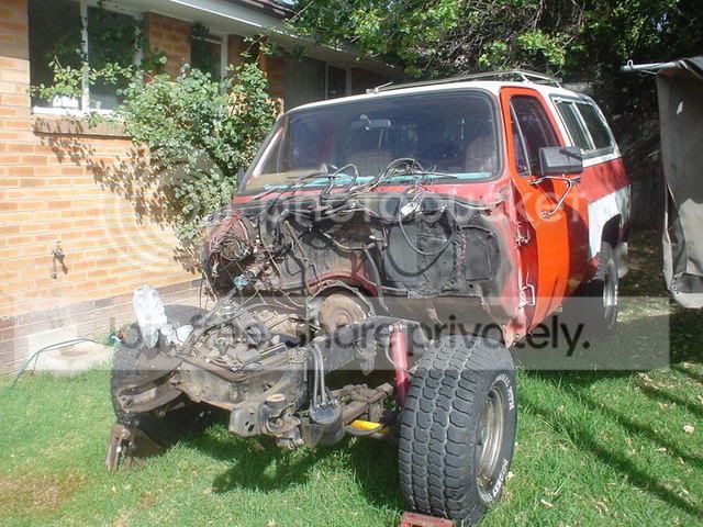

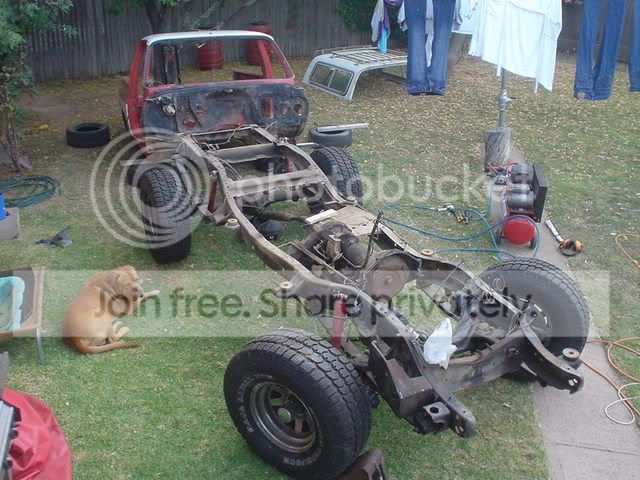

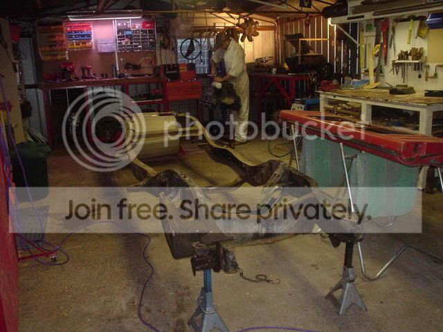

Its been a hectic couple of weeks. I've had to knock over a long list of jobs to clear space/time before I started the resto in earnest. Anyway everything is set now and the K5 made it into the garage yesterday.
I knocked up a dolly that will do double duty on my next project (muscle car) as a dolly and then evolve into a build jig. The dolly was built to suit the muscle car perfectly and 'fit' the K5 enough to make the tub resto easier. Being able to move the dolly up and down is a must as the garage roof bars are only 6'4". Its going to be musical truck parts until the tub goes back on the chassis, then its outside only.

Ive got some work to do initially to fix up some sh$t done in either the conversion or buy a PO.
Damn pop rivetted crap.
Somone had cunningly hacked the tub to fit some 6x9's not understanding just how much dust that hole would draw into the truck.
The chassis and tub are going to the the blasters on monday.
I've got to give my K20 a freshen up so it can get sold to help take the build past a standard resto. I cant wait to order some of the bigger items.
So far so good, I'm only a few days behind the schedule I projected for this build.
