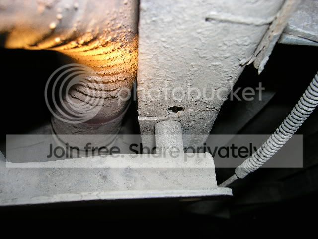

Well went wheeling over the weekend and bent the frame as I was looking over the K5 I found this crack:eek1:
I'm trying to figure out how to repair it for Blazer Bash. Do you all think I can weld the crack and maybe put some steel plates on both sides of the frame and weld it? All I need it to make it to BBO7 and from there the body and frame are going to the dump.

Is that crack at the trans crossmember?
If you ground the crack clean, drill a hole at the end of it, weld it closed & then plate the frame it should hold. Easy on the heat though, or you weaken the frame at either end were you plate it.
Holy crap! You didn't have the round spacers between the frame and crossmember did you?
I think you need to drill a hole in the end of the crack. Weld it up and plate it. I have plenty of scrap steel around the shop to fix that if you want to come up here to do it. I'm crazy enough to weld it for you, too. :dunno:
Nick's started cracking there, but not near as bad. His was from those stupid round spacers moved between crossmember and frame. We replaced them with flat stock.
I was planning to fab up my own tranny crossmember this winter. I'm glad I have you to tear your rig up so I know what to fix on mine. :whistle: :rotfl:

Any chance you could get a picture of that? My truck has the spacers between the crossmember and the frame, and if that allows the frame even more chance to crack, it's definitely something that needs fixed.
Try and align the crack as best possible. Stop drill the crack and weld it up. Grind it flat then take a piece or 2x4" 3/16 or 1/4" thick angle iron and place it over the crack and under the frame rail. Weld it on and drill new holes for the crossmember.
That is how a pro fab shop repaired mine back in the day when I ripped the chunk of frame out where the crossmember bolts. I lost about a 1.5x3" piece of frame rail that encompassed both tranny crossmember bolts. My trans and tcase were trying to fall out of the truck. :crazy: This was back in my days before wheeling, I was just on a dirt fireroad and it gave out. I had to jack the crossmember back up and chain the crossmember in place to get home. That was my first real trail fix. :D

That truck is long gone. The only thing I can find is the original frame crack that we repaired. :dunno: It developed more problems elsewhere in the frame. :doah:

No spacers on the crossmember. Well I know what I will be doing this weekend doing some welding:haha:
