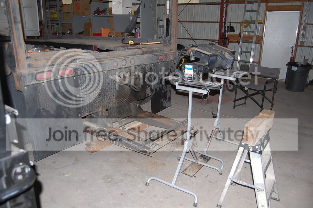

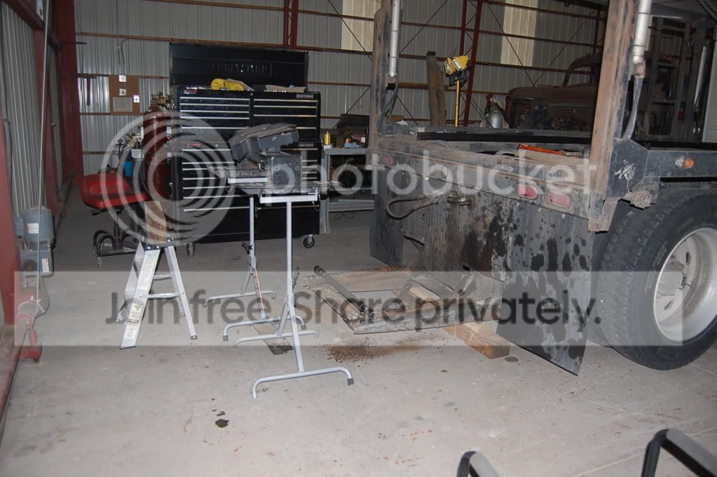

Got some work done today. Stripped the old hitch and rack. Rack had not been moved since new. Had to cut the air ram and the cross plates. Then pried the pieces off. Cleaned the rails.
Set up the new hitch at 25 inches off of the truck and 50 inches off of the ground. Started checking more dimensions. Blew a number of them. Jimmy is 15'-2", not 14'.
Had to move the hitch back to 46" off of the back of the truck. This gives me turning clearance and sets overall length at 70 feet even. With the stinger I can go to 75 feet.
YES IT WILL WORK.
Looks funny in the pictures. But when the bed is finished. It wont look so far out there.
New location. A new bed will be around this. It will be part of the ramp system to get the truck and car on.

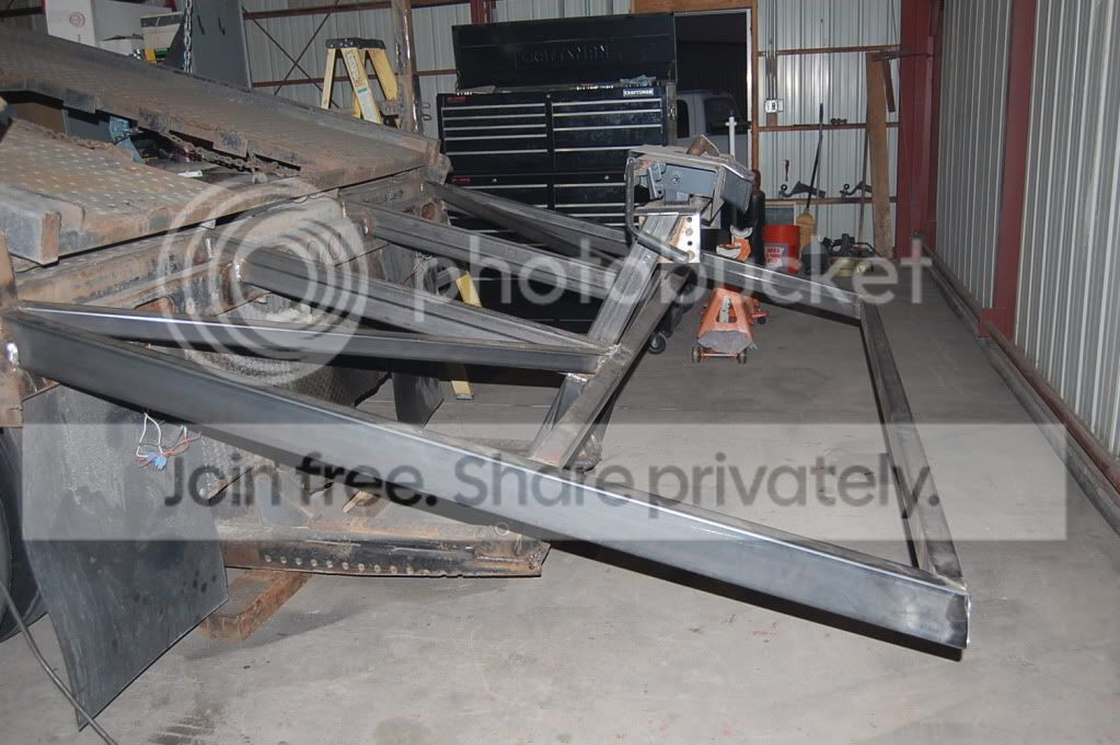

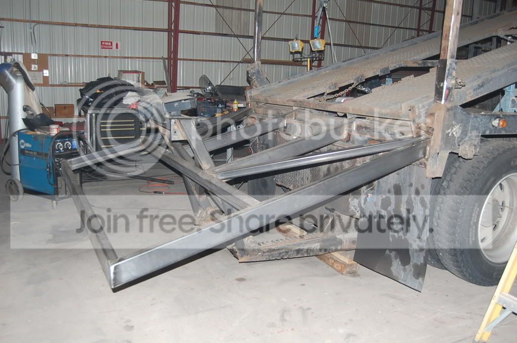

More work done. Not looking like much. But to get it centered and square on a bent rack frame, took some doing.

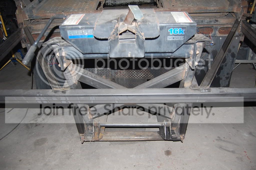

set up the new hitch location

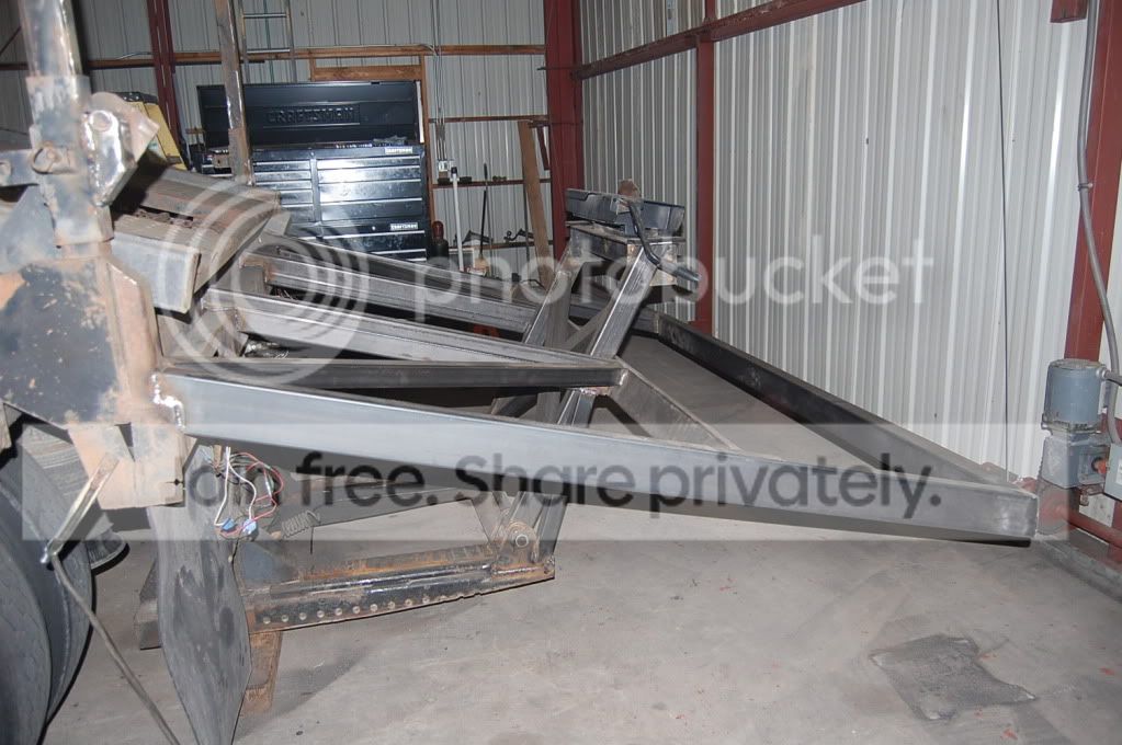

rear frame and hitch support. the frame is part of the ramps.

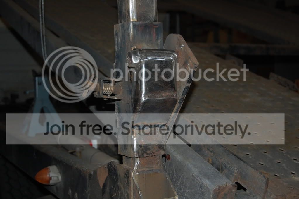

relocated upper rack supports at rear.
If I can just figure out how the get the front of the upper rear deck to go all of the way down, then back up. The math is killing me. 28 degrees in the shop is not helping.
